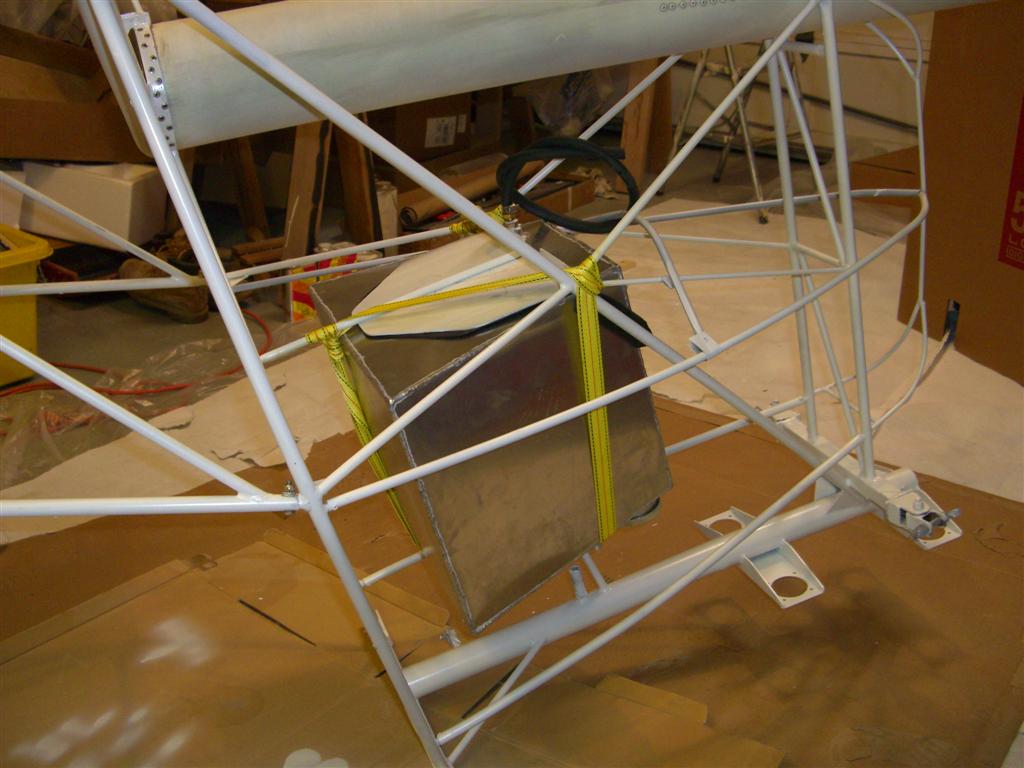

Here is the company that made my 8 gal tank. The tank is working great. No leaks. http://www.alumiworx.com/cart/index.php?act=viewProd&productId=20
