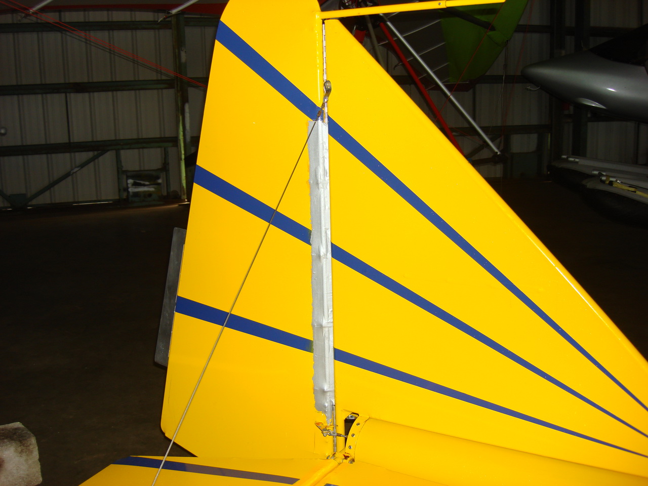

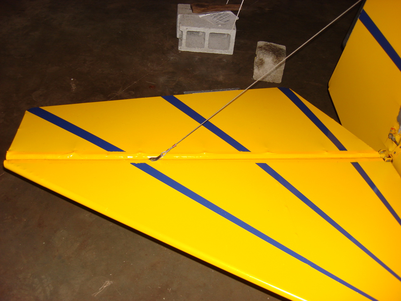

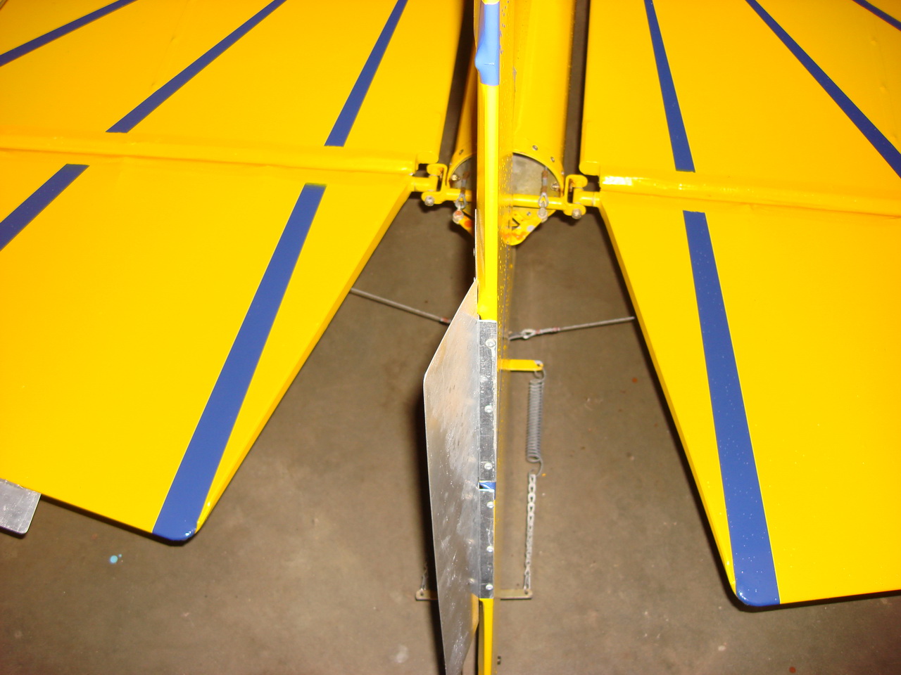

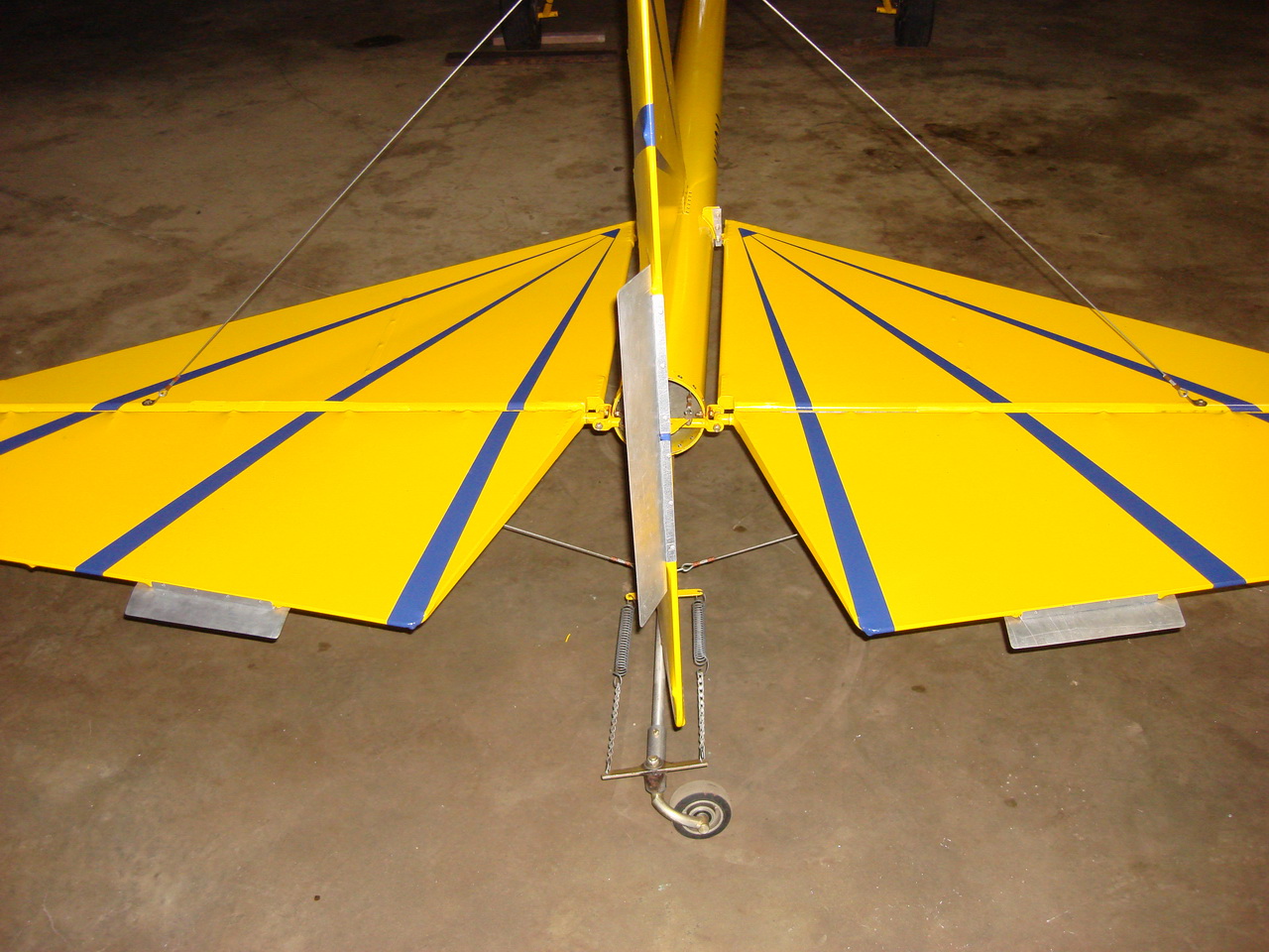

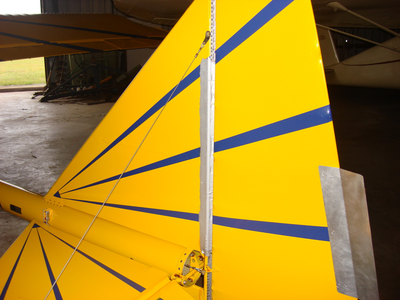

Installing Gap Seals in on a Kolb is a very easy way to make the flight controls more responsive. Most people already have gap seals on their ailerons which is a great help in roll, but putting gap seals on the elevator and rudder can also help those control surfaces. Attached are some pictures of my Gap seals, I used light Polyfiber fabric and just attached it the way the book says to do a patch, its worked very well. I put the gap seal on the top of the elevator because on my Kolb, the horizontal stab on my Kolb is rigged in such a way that the air is always pushing it down ( Yours may vary depending on a lot of things ). On the rudder, I put the gap seal in an S pattern attaching to the left side of the Vertical tail and the Right side of the rudder. This means that no matter which way I push the rudder the gap seal stays in place. I would highly recommend that elevators also be done in the S configuration top to bottom also, having a gap seal lift up could create a very bad and dangerous condition !
Results were very positive, I have more elevator authority for heavy passengers and forward CG loadings, and my standard Kolb spring elevator trim system is effective over the entire CG range of my plane. On the tail, the effect of the increased authority can clearly be seen by how much I had to bend the trim tab to get the Kolb to fly straight in Cruise. The clear lexan tab was the standard Lexan trim tab bent to the standard 30 degree angle that Most MK III's require to fly straight before the gap seal was added to the rudder. After putting on the gap seals, I only needed about half as much bend in the rudder tab for the plane to fly straight at cruise as can be seen in the new aluminum tap, demonstrating that the rudder is now more effective and requiring less trim and deflection for the same cruise condition.
Mike

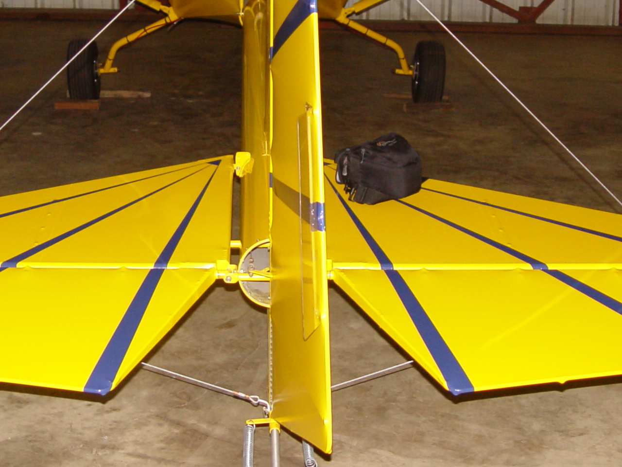

The change in trim tab material from Lexan to aluminum was done before the gap seals, here is a better picture of the original bend in the aluminum tab, and then much lesser bend for coordinated cruise after the gap seals. The amount of bend in the first picture is much more than it looks, as the camera is not looking at the rudder from straight on, I took about half the bend out.
Much less trim tab bend required after the installation of Gap seals.
 Filesize:  265.98 KB
 Viewed:  4019 Time(s)
Trim tab Bend required for straight cruise flight before Gap Seals were installed.
