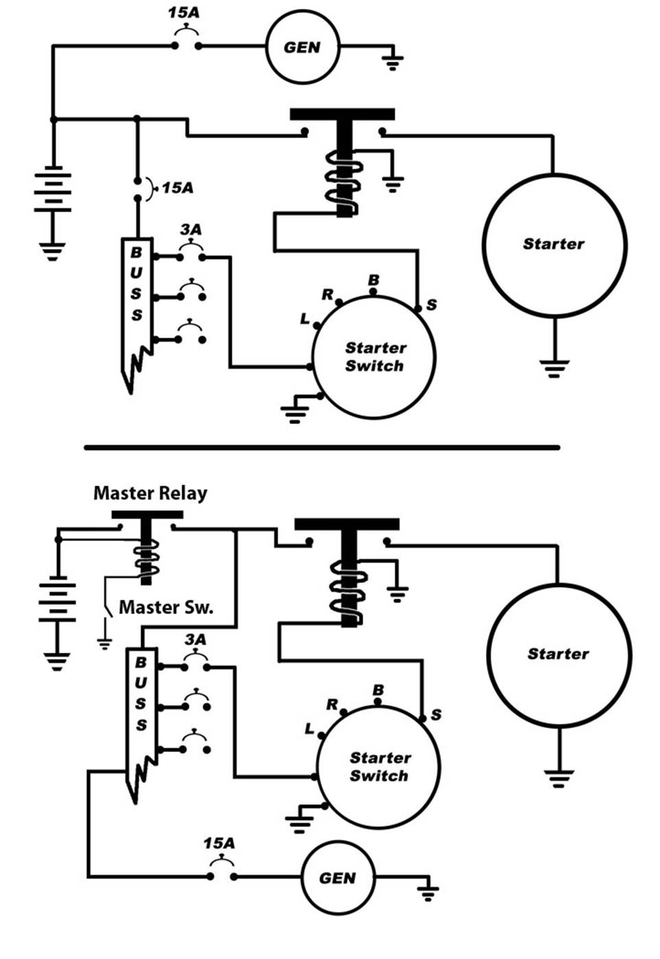

You must have missed the followup. Yes, I meant the battery side of the starter relay.
Ignoring the W/B issues as this aircraft has seen a lot of airtime
I want to get rid of hot wires behind the dashboard when the Master is discoonected. The battery is located right over my feet and the starter relay is sitting on the engine side of the firewall directly opposite the battery. Two inches away is the REG/RECT. I simply want to remove all the wire that went from the REG/RECT along the back of the dash to a panel fuse and then back to the battery as it was energized all the time and brought about 24" of live unfused wire to the panel.
I would like clarification on your statement about a breaker on the REG/RECT lead. ROTAX's own wiring diagrams do not show this and many UL wiring diagrams do not. See http://www.ultralightnews.com/engineinfo/images/264-870wiringdiagram.jpg I know that some Certified aircraft have a ALT disconnect.
The power for the panel is not an issue, my biggest concern is if I want to remove the LORAN the Strobes. I am extremely envious of an aquantance who wired a RANS with about eight feet of wire. VERY VERY simple. Mine will be more complex as I more engine instruments and fuel gauges but I think he has the right idea.

See now there's the issue. I should be fine with a none or all approach. If I lose every single powered device on the panel I'm still fine to fly day VFR until I can land and fix the problem. Which would be much easier the simpler the system is.
If I was flying a high alt passage through multiple control zones at night in IFR conditions I'd need all that. But I wouldn't be flying a Kitfox.

Best thing is to put a relay right on the outside of the battery box that will disconnect the B+ from the battery when the master is off. The energizer line for the relay can be as small as 22 ga and be protected by a fuse at the battery B+ terminal. So much for the hot wires when the master is off.
The idea of having a breaker on the charging system is twofold. First if that breaker pops then you probably have way too much load on your buss so it’s a little past time to start to turn a few things off. Secondly if you suspect that the charging system is not working then your regulator circuit may pull a Benjamin Arnold on you and actually help flatten your battery in flight. A switch to disconnect the regulator from the circuit in that situation is worth its weight in gold. When the engine isn’t running that wire is totally cold.
This diagram shows two ways of doing the same thing but I prefer the second method as everything is cold when the master and gen are pulled. In the first diagram it is not possible to operate an electrics with a flat battery as you cannot isolate the battery from the gen.
The relay in the second diagram is a min 60A unit often used in RVs. It is important not to use a starter solenoid as they are only designed for momentary use. Notice I didn’t show a breaker or fuse on the energizer line for the relay.... my plane has a fuse.

I agree if your radio has a separate battery. Yes I know you can fly NORDO I’ve been in planes where it has been done but... Do you really want to do it?
Daytime VFR only

PostPosted: Sun Mar 08, 2009 12:47 pm    Post subject: Rectifier to battery connection question. Reply with quote
Noel C Did you mean Benedict Arnold? Or Benjamin Franklin on that battery hook up?
Daytime VFR only
Noel
From: owner-kitfox-list-server(at)matronics.com [mailto:owner-kitfox-list-server(at)matronics.com] On Behalf Of Dave G
Sent: Sunday C March 08 C 2009 1:52 PM
Subject: Re: Kitfox-List: Rectifier to battery connection question.

At 12:19 PM 3/7/2009, you wrote:
This arrangement will leave the regulator attached to the battery full time, but fused. I'm aiming for simple here folks.
My question is whether the fuse will blow with an over-voltage condition. Fuses normally only care about amperage. If your regulator decides to go over-voltage, (the way mine did,) I can see you causing problems for any electronics receiving that voltage.

Benedict Arnold... gee I wish I could say I was into the run again but alas it was just a brain ####.
Daytime VFR only
Noel
Sent: Sunday, March 08, 2009 1:52 PM
Subject: Re: Rectifier to battery connection question.

Ok. Wiring to the battery side of the starter solenoid doesn’t allow you to cut power from the alternator to the main buss without also cutting the power from the battery. The power being generated and rectified is less than 16A DC (at) 13.8V. Hardly heavy current carrying wire. Doing the wiring the way you suggested only allows a none or all wiring approach. Having a 16ga wire feeding the buss through a breaker then allows you to run either from the battery or the alternator.
BTW I recommend that you have a master relay as close to the battery as possible to protect the heavy starter wire. If not a relay than at least a fused link capable of carrying the starter current.

Got a private reply that didn't help. Yes folks I meant the battery side of the starter relay, not the starter.

Can anyone see any reason why I can not or should not keep all the wiring from the rectifier / regulator on the engine side of the firewall.
I want to remove these wires currently penetrating the firewall and have the positive side go to the battery side of the starter through a weather tight fuse and the ground side go to the battery ground on the engine.
