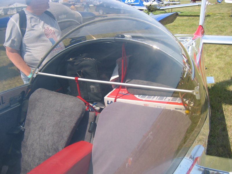

Paul,
I would be concerned about stressing the bubble and cracking it. Remember, you will have to pull it in past the desired spot to put any more bend in the hoop.
It sounds to me that this airplane is already built and the canopy does close, just not very well. If that is the case and you are only talking a little bit to get the latches lining up better, you might want to consider the bar shown in the attached picture. Maybe it will help. I saw it at Oshkosh in 2007. As you can see, this builder also incorporated a rope to help pull the canopy down as well as too keep it from opening too far on a windy day.
Good luck,
 Filesize:  88.4 KB
 Viewed:  5004 Time(s)

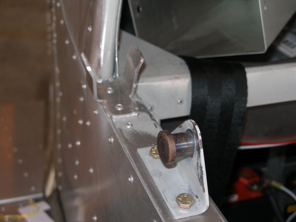

PostPosted: Fri Mar 06, 2009 10:09 am    Post subject: No Title Reply with quote
You might consider that bar, plus guide clips as shown on the attached photo.

PostPosted: Fri Mar 06, 2009 10:24 am    Post subject: No Title Reply with quote
Sorry, I attached the drawing for my airplane. Yours might be different. See attached photo.
