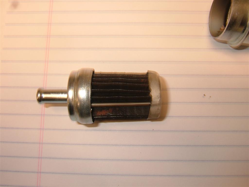

Ok guys here is the skinny...about 2 months ago my engine started to run a bit rough in the higher power ranges (80% and above) but idle through 75% was good as always. Now my engine only had 25 to 30 hours on it when this started. I have been tinkering with different things trying to figure it out but was not able to find anything out of the ordinary. I have suspected my fuel system since this began and started with my finger strainers which were clean. Next my fuel goes through a 40 micron Earl's filter and it was clean so I didn't bother checking the final filter right before the engine. I then moved to the carbs and they were fine. So in a last ditch effort, I decided to completely redo my fuel system hoses and this is where I found the problem.
Here is how the fuel is routed so you can follow. Fuel from the tank goes through the finger strainers, through about 15" of -6 Aeroquip AQP hose and then through 3/8" 5052 aluminum tubing to the header tank. From the header tank through more 3/8" aluminum to the 40 micron filter then to the fuel shut off valve. From here it transitions to 1/2" Mil 6000 hose for about 6" to the pumps then 5/16" Mil 6000 hose to the final filter (shown in pic) then to the fuel pressure regulator then to the carbs.
As you can see, this final filter is completely gummed and plugged up. I can barely blow air through it. As stated earlier, my other filters (before the mil 6000 hose) were clean. So here is my diagnosis: Mil 6000 hose is deteriorating and plugging the final filter which is not allowing enough fuel for the high throttle settings. My engine is a 914 so cruise power is about 5.5 gph but full power is almost 9 gph.
Solution: Get rid of all mil 6000 hose and replace with suitable Aeroquip hose or aluminum tubing. I also see that Aircraft Spruce says specifically not to use the Mil 6000 with fuel. Just as a note, I have checked my fuel source a couple times and have not found it to contain any ethanol

The light brown is the filter element, the dark brown is??? Hose liner maybe?

I was reading your report and came to the entry "MIL 6000", and
figured that was it. Somewhere in the past I had read about this
stuff on this list, and made a mental note to not use that which came
with my kit. I went with the SAE 30R7, and it has worked without fail.

Correct. Lose all of the Milspec and go to the Aeroquip or good equivalent.
It may not be the ethanol, but other chemicals in auto fuel that is causing
a deterioration of the Milspec. This stuff has been happening long before
ethanol was being used.

Goodyear now makes the SAE 30R9 that has a blue inner lining made for use with Ethanol and alternative fuels. It is very flexible without kinking and has a small outer diameter. Many auto parts, such as Autozone, stores sell it by the foot. SAE 30R9 is rated for fuel injection lines.

This is my thinking as well I know I have not run ethanol but the detergents and additives may be the issue. Clint has used the Mil6000 for 1400 hours without issue but I think he runs 100LL...I could be wrong though.
I bought some Gates Multi-fuel fuel injection hose today that I am going to use for the 5/16" lines...the other stuff is Aeroquip.
Thanks for the replies.

Sorry to say, Darin, but this is really old news which I'm sorry you
had to re-discover. I hope it still shows up in the archives. Most
guys have gone to SAE fuel injection hose, though some, like me,
still use the clear blue.

Is this the $12 per foot stuff? I was picking up some fuel line for
my plane a few weeks ago, and couldn't remember what the number was,
but thought it was fuel injection hose and the guy mentioned the
price, and I *quickly* remembered that it wasn't THAT stuff. : )

Service Letter #45 has a caution about oxygenated fuel deteriorating the Mil spec fuel line.
Here's the quote from that service letter.
"In addition to the tanks, the fuel lines which are used in the aircraft may be susceptible to deterioration from these fuels, including the aviation-grade MIL-spec hose which is currently supplied with the aircraft. Because of this, SkyStar does not endorse the use of any oxygenated fuels except those which have MTBE added to them."
Direct link to service bulletin #45. The reference to Mil spec hose is at the bottom of the last page.
http://www.kitfoxaircraft.com/support/service_letters/sl45.htm

I would be happy to send you a piece of the line but please explain how you intend to test it as I am curious? I only have small sections, none long enough to install for use.
Tom,
I find it interesting that they say oxygenated fuel deteriorates Mil spec fuel line as the manufactures listed in the military spec (Gates and Thermoid) both list the line to be completely compatible with alcohol. Who are we supposed to believe? And my fuel is not oxygenated.
http://www.hbdthermoid.com/images/aviation_ducting/Aeroduct.pdf
Check out page 4...it doesn't say fuel anywhere in the description. Also, Aircraft Spruce specifically says that the Mil6000 is "Not recommended for fuel line".
http://www.aircraftspruce.com/catalog/appages/mil6000.php
At this point, I really don't care if people have used this hose successfully for a million hours...there are enough documented cases of problems that I am getting rid of it.
Darin Hawkes

I bought some Gates fuel injection hose that is SAE30R9 spec also from a local hose supplier. It says on the hose that it is multi-fuel compatible. Here is a link to the Goodyear stuff.
http://www.goodyearep.com/ProductsDetail.aspx?id=14912
A check of Autozone's website though shows it at $12.99 for a 5/16" x 18" piece which is closer to $9.00 per foot. I paid $6 something a foot for the Gates SAE30R9 hose. $3.99 per foot is more in line with the fuel emission hose that your local shops sell. But if you can get the SAE30r9 for that price your getting a great deal.

As an update...I got all the hoses replace and the filter changed out to a new clear filter and sure enough, the engine hit 5730 rpm on a static run so all is well now. I bought myself a new gadget called a Carbmate electonic carb synchronizer that is awesome...I will post a new thread and discuss my thoughts on for anyone interested.
