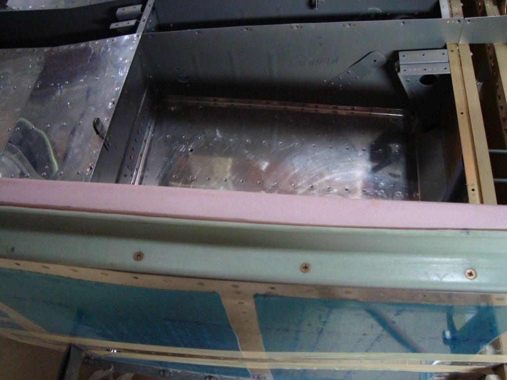

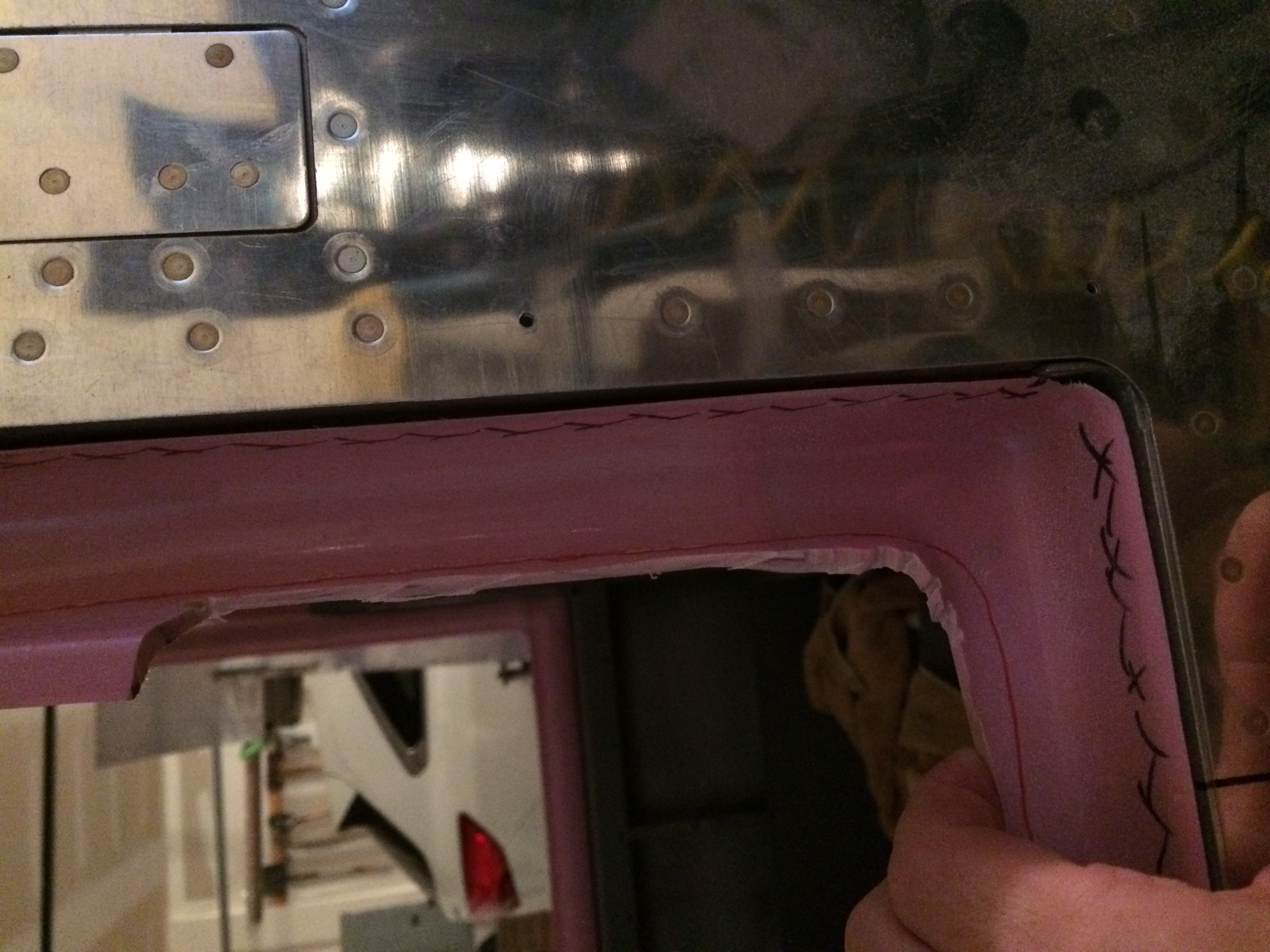

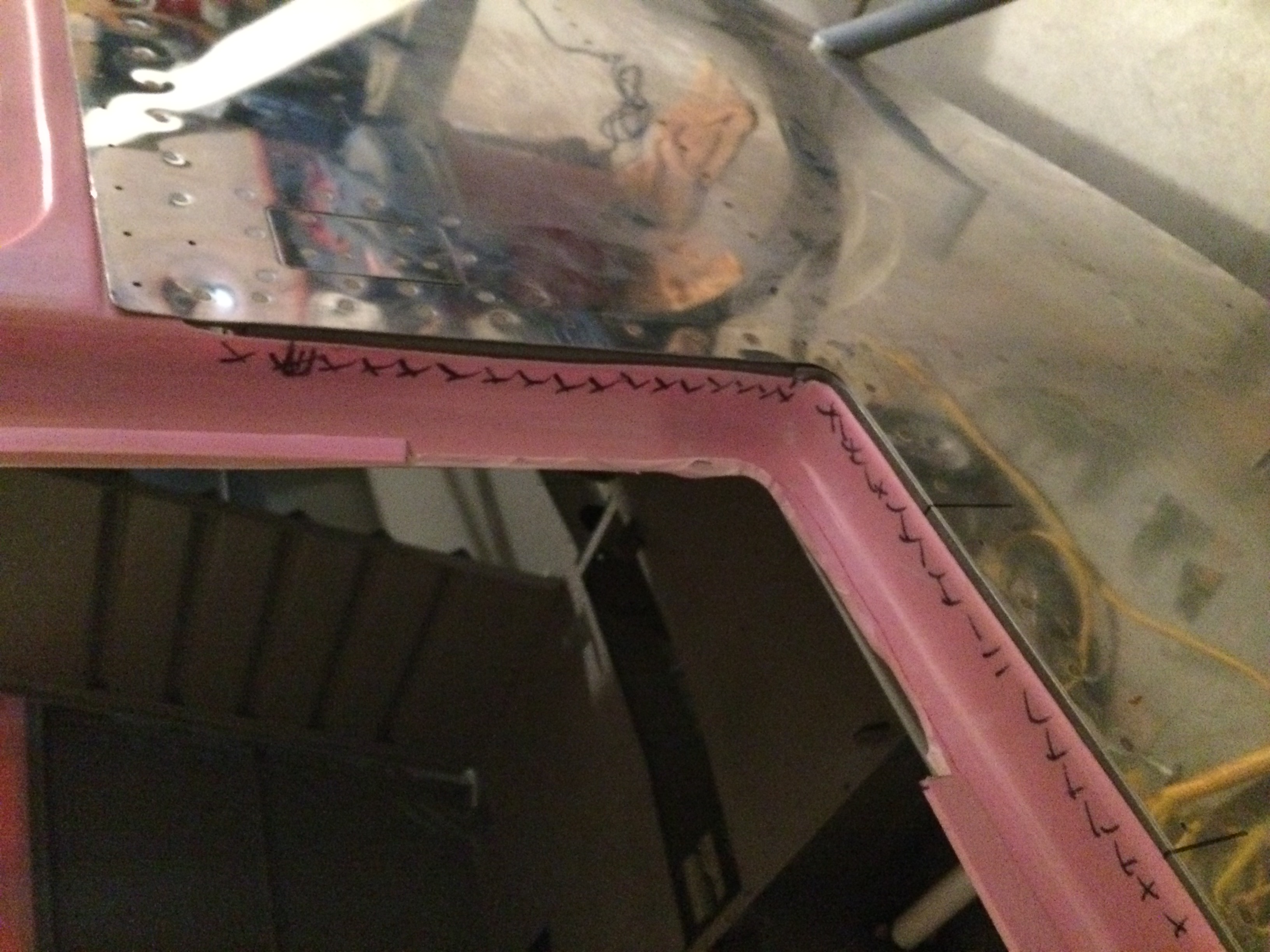

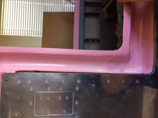

Hey all - I am new to forum and I have been hesitant to post as I have been able to find most of answers by looking at past posts or talking to my EAA tech counselor, but I haven't found a good answer yet to my latest concern.
The build has gone great, but the cabin top has given my some problems. I spent a lot of time getting it to fit and now that finally got it to slide into place I have a gap problem - see pics. I assume I can add resin with some filler to fill in gap and re-sand to fit, but my concern is that I have a tight fit already and I think is has somewhat do with head of universal rivets in door opening of fuselage, but then again I see other builders with a better fit. Any suggestions on how to proceed?

We usually lay in a fairly healthy head of medium thickness flox before setting in the cabin top so it fills any voids like that. After we tighten all the screws we make sure to remove any excess before it cures. A tight and clean trim is the best way to achieve a good fit, but the flox helps in areas that don't fit as well.

I do not recall the fiberglass resting on any AN470 heads.

Hey, by chance do you have the QB fuselage? If so, go back through the plans and you will find that those AN470 rivets that are in the way are REALLY supposed to be AN426 flush rivets. I had this same issue and it literally took more than an hour to find it in the plans. There should be NO AN470 rivet heads protruding in the area where the cabin top sit in the fuselage sides.
I think it was about 8 rivets, four on each side. They were pretty easy to drill out, dimple, and replace with AN426 rivets...
It is one of the issues I found with the QB kits...

I do have a QB fuse and indeed the 426 rivets are placed in error. That is why Bob doesn't remember having them there. So now that I have already trimmed to much and cannot get it to clamp flush in sides of door opening (sits flush on bottom) how should I proceed. Obviously replace rivets, but then what do you think. Epoxy resin with flox and re-sand to fit? If so, will it adhere and be strong enough?
This is one of many problems I have had with QB fuse, just didn't catch this one early enough- wish I would have just build it myself

Yes, like Jesse mentioned, apply flox and bolt it down. It's a pain to sand, so don't got crazy with the flox.
I got mine to fit pretty good. I used flox to fill in the door bottom on the interior then added micro as a top coat and to fill in all the imperfections around the edges.

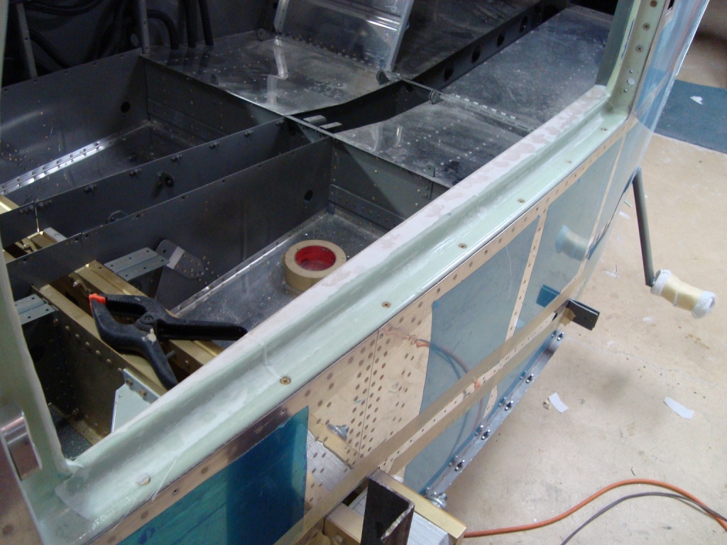

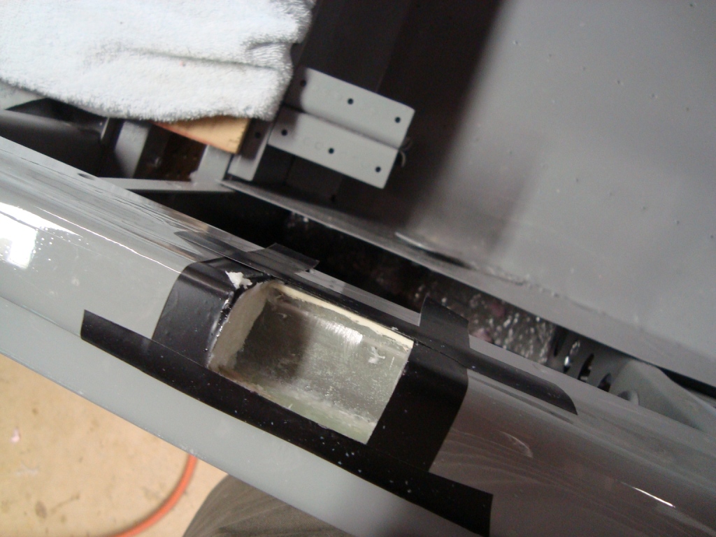

This is a single step fix after you replace the rivets. Apply a liberal
amount of flox, install the cabin top, clean up the excess flox once the top
is seated (and before it sets) and insert the bolts. Remember to not
tighten the bolts all the way until after the flox sets so you don't deform
the cabin top. As you will have a lot of flox to fill the gaps, check that
the sides and bottom are straight as you go. Once this is done the top is
there forever so don't scrimp on the flox. It is much easier to clean up
the flox as you go then to try to fill voids after the top is on. The flox
should not be too runny or dry. Something on the wet side of cake frosting.

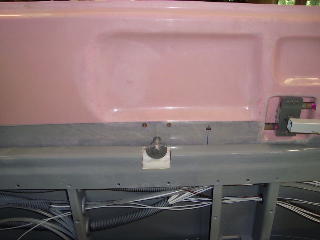

When done there a several options to fill in the door bottom. On Van's demo
plane they used a piece of wood. The attached photos show how I added some
rigid foam and then 8 bids or so of glass over the top and down the inside
to aluminum. Some micro, sanding and ready for paint. The last two photos
show how I back fitted the aftermarket door cam lock. I suspect this turned
out easier than trying to glass around it. What would we do without Dremel
tools?
Carl

I'd consider rubbing a mold release all over the aluminum and then bolting it into place with a handful of shims to fill the gap.  This means the shims would be the same width as an AN470 head rivet it tall.
That would locate the cabin time in the correct position.   With it in that position, I'd then squeeze some epoxy/flox into the gap where the shims are between the aluminum and the cabin top.  You can use a large syringe to pack the flox way back into the gap first and then fill until you get the the outer edge.   Wipe the excess away.
Once it has cured, you can tap the shims out and fill the hole where the shims were the same way.
Once that has cured, you can take the cabin top off and inspect it to make sure there are no voids and if there are then you can just fill them to match while it's off.
You will end up with the most perfectly fit cabin top of the group that way.   You're basically using your airframe as a mold and building the cabin top to fit it perfectly.

Boy, I dunno if I would try to remove the top after the epoxy has set, even WITH mold release. With the imperfect surfaces of the cabin top, I would think that you would damage it trying to remove it with the perfect fit you created. Unfortunately, you would then be stuck with a cabin top that is not bonded to the surrounding epoxy due to the mold release, and no good way to remove it without breaking it.
Make sure the cabin top is in the right position and fill'r'up with flox...then tighten the bolts when flox is cured...

So my concern with this approach is that will I have a problem clamping cabin cover to fuselage to match drill bolt holes with that large of a gap. You are saying just not worry about gap until final seating and they secure with flox an not try to build up prior to final seating?

I am certainly no fiberglass expert, but I'd be tempted to lay down a couple of layers of fiberglass/epoxy on the bottom of the top, where, you've sanded too far, to minimize how much flox you need to fill the gap.

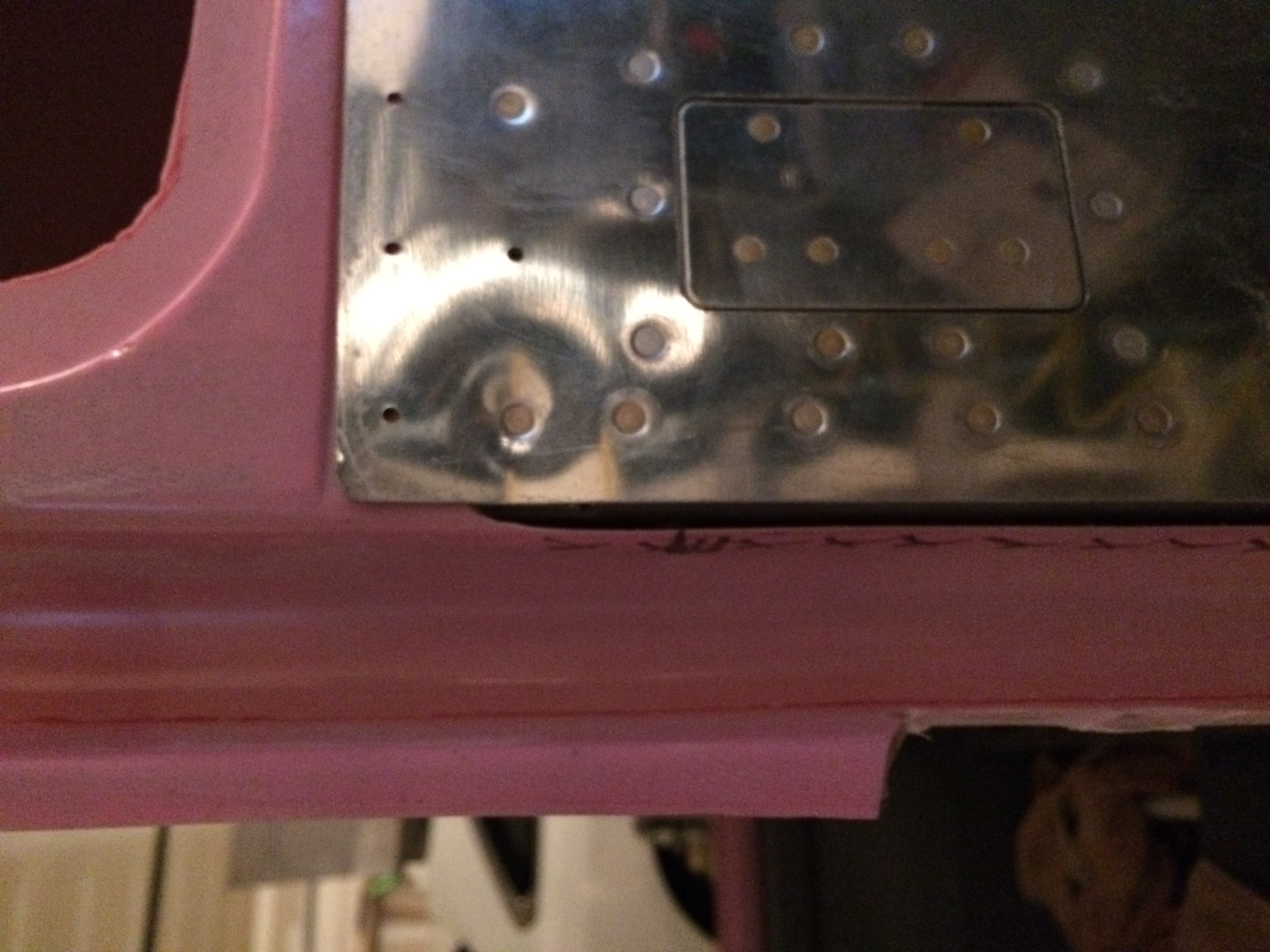

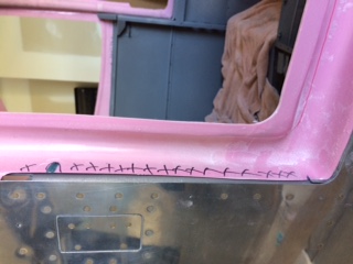

By the way, the lower or bottom portion seats fine, just sides, attached better pictures

Not to go against the trend.....but why take our the 470's. If you have it
fitting....already cut the top....then just leave the "wrong" rivets in and
flox around them. Will help keep everything lined up and the will not
affect the structure. Drilling out the rivets and putting in new rivets
only increases the risk of messing something up.

I agree with Rene.  If it fits, don't bother drilling out those rivets.  I would lay a thick layer of flox or milled fiber filler between the top and the fuse to fill the gap before drilling for the attach screws.  The problem with a release in an area like that is some resin will inevitably seep into some cavity or female section that makes it very difficulty to remove.  It can be done with a lot of prep and forethought but it wouldn't be worth it.  Filling will work just fine.  Keep it a little "below grade" to reduce having to remove cured material--you can always bodywork it for cosmetics afterward.
Once the top is on, it's an integral part of the fuselage.  Taking it off in the future might be possible but you'd need a really good reason.
