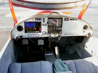

I cut mine off, and it works just fine.....Fred Sanford N9601
Pix attached
do jnot archive
 Filesize:  38.21 KB
 Viewed:  8246 Time(s)
sonar1@cox.net
Joined: 02 Oct 2007
Posts: 55
Location: Santa Barbara, Ca
PostPosted: Mon Mar 02, 2009 12:54 am    Post subject: Y stick problem Reply with quote
I cut mine off. Tried to attach pix to previous message - didn't work.
Try this:
http://www.sonar100.com/panelwgpson.jpg
Fred Sanford N9601 do not archive

Bill, I have the Y stick in my 701, and I have the shortened stick in my
601. Two different planes - but I see no difference. The shortened stick
allows me to relax my forearm on the center divider. I have seen that
others have had to add cushions to the center divider for flying with
the Y stick. As far as vertical sensitivity, I feel that the the
wandering comes from the plane and air currents rather than lack of
response in the stick,,,,,,,Fred N9601 do not archive

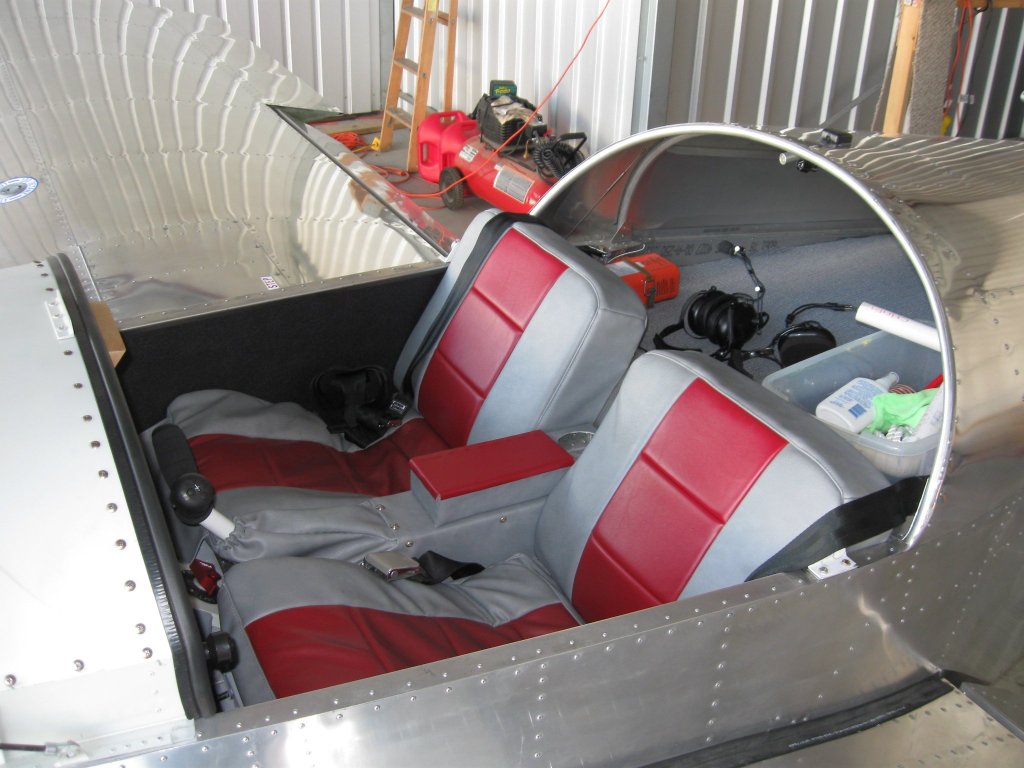

You guys have seen others do this, and most AMD's also, take the opportunity to turn the center arm rest into a storage box. Here is mine. The box top pivots towards the passenger seat and allows enough room for my wallet, keys, extra pens, small LED flashlights, etc. The aft portion has a drink holder for a water bottle.
When I have my roll axis AP engaged, I too find myself holding the stick just below the Y to control altitude.
Love the Y-stick!
