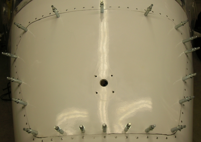

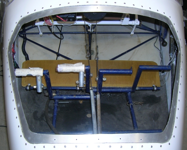

The first thing I realized when I decided to create a new wiring harness for my Mk III was that I would have to be a contortionist of extreme flexibility in order to accomplish the task. After much hemming and hawing I decided to cut the nose and create access that would give me access for this project and future maintenance, too. My first thought was that I would be able to use european style articulated cabinet hinges on the forward edge so the hatch cover could be easily opened and the flange around the opening would be fiberglass bonded to the inside of the nose cone. That didn't work out since the nose cone is made with polyester resin (I'm guessing here because of the smell of the resin as it was cut) and the nose cone and the cut out both relaxed after the cut and distorted so much that I elected to use .025" Alclad aluminum for the flange and attach it with 3/32" SS pop rivets. Things I learned from the project:
1. Do not use an abrasive wheel to do the cutting. No matter how I tried to steady my hand, the cutter sucked in up to the hub when I cut the corners and created a jagged cut. It's an easy fix, but I think I could have avoided the problem.
                  If I had used a router bit and created a thin plywood guide frame I could have perfected the cutout in the frame.
                  If I had used the cable drive handset I could have held the handset flat against the surface of the nose cone.
2. I should have made a frame to support the nose cone before cutting and attached it with small blobs of Bondo to prevent the nose cone from distorting. This could have been combined with the cutting frame idea to kill two birds.....
3. I could have taken a splash off the nose cone and used it to create a mold for a new reinforced hatch cover so the hinge idea would have worked.
4. It would have been only a little harder to copy Mike Welch's nose cone and build the hatch in from the start.
Rick

Rick, you deserve at least an attaboy for that work. It looks
great. I'm a firm believer in being able to
access and remove stuff. 10-32 screws are much better than rivets.
My windshield, nose bowl and doors are all easily removed. My panel
is accessed with one screw and and velcro.
BB

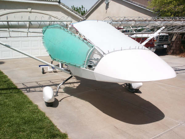

mdnanwelch7(at)hotmail.co
PostPosted: Sun Mar 01, 2009 3:38 pm    Post subject: Nose cone access Reply with quote
Rick C
  I don't quite understand your reference to my nosecone.
  After two attempts at making a decent looking nosecone (and I wasn't pleased with either version) C I bought an authentic New Kolb Co. Xtra nosecone. (as seen in the attached photograph)
  All chromoly tubing alterations on my MkIII are identical to an genuine Xtra.  I had detailed measurements and photographs from an Xtra fuselage.
  Although I tried to make my own nosecone C I decided a real Xtra nosecone would be better.
  However C your access door is timely information!!  I needed to get access to the front area C also.  You just helped me figure out how.  My access will be from below C though.  Thanks
Mike Welch
MkIII

PostPosted: Sun Mar 01, 2009 4:26 pm    Post subject: Nose cone access Reply with quote
That is quite a cargo hole. Wink
I had to cut an access hole in the bottom of my nose cone to gain access to the brakes. Hated doing it, but only choice I had. Mine is only 6" X 12" (or close to it). Just enough room to get my hand up in there to work on stuff: antenna, master cylinders, brake pedals, and brake fluid resevoir.
I used nut plates and SS dome head screws to attach with a sheet metal flange riveted inside.
Wish I had a big hole like that to work through. Would make life much easier when the time comes.
