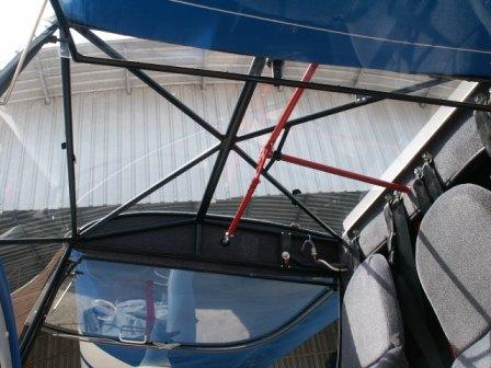

2. A rod in the cabin attaches to the triangular bellcrank and passes thru 2 nylon bushings one of which is in a tube welded to a flange and attached to the bulkhead near the top seat belt attachment points. (see photo). It looks like the factory had not welded the flange correctly. It was misaligned quite badly and appeared to show attempts to bend it to fit. The rod missed the bellcrank by about an inch.
We replaced the long pushrods with a stronger tube and used spacers to correctly align the flange. Now the ailerons are very light and feel normal. I can only assume that the factory used the wrong spec pushrod on our Allegro or there is a third set of bearings missing which seems unlikely.

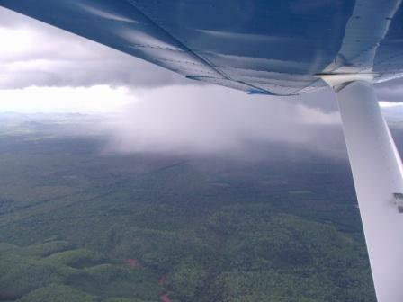

If the wing pushrod is bending, it will be visible in flight. The photo clearly shows the ailerons at cruise speed bending up to lie flush with the reflexed flaps (therefore 4.5 degrees) and way above the tip fairings.
