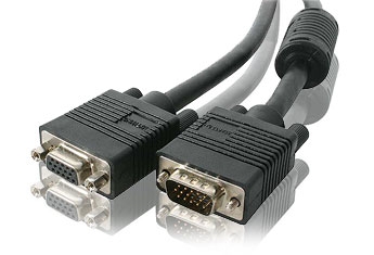

With respect to the usefulness of cores over an
antenna feedline, the practice is problematic.
Many commercial cables are fabricated with such
devices installed.
[img]cid:.0[/img]
We read dozens of articles/conversations on the web
that suggest they are "good" and just as many who say
they're a "waste of time".
