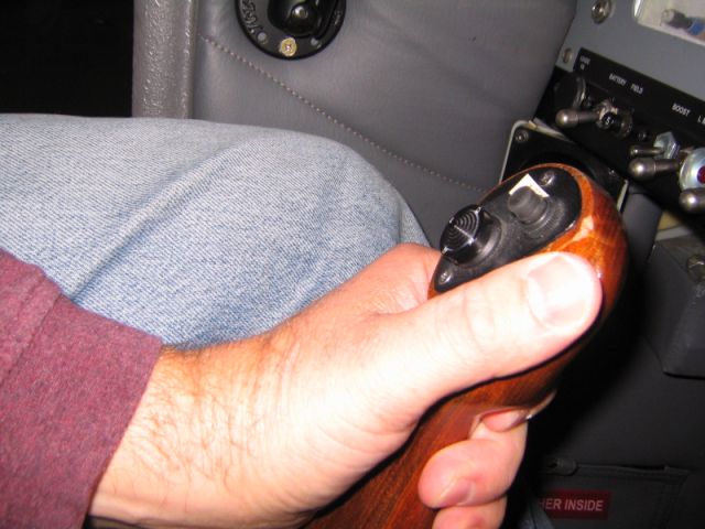

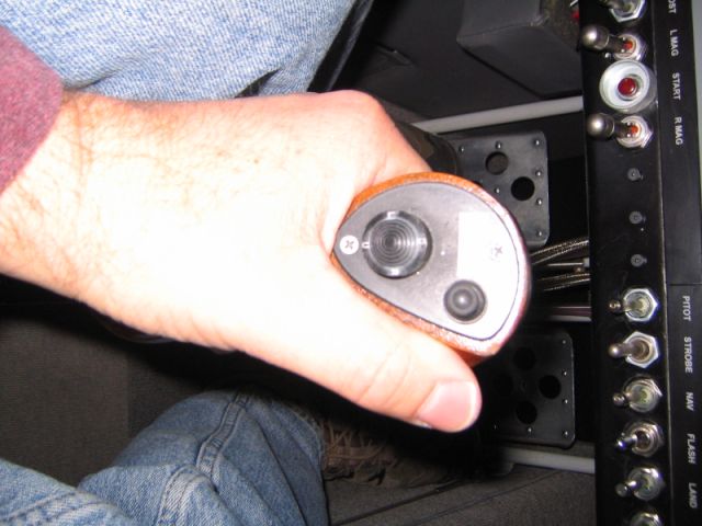

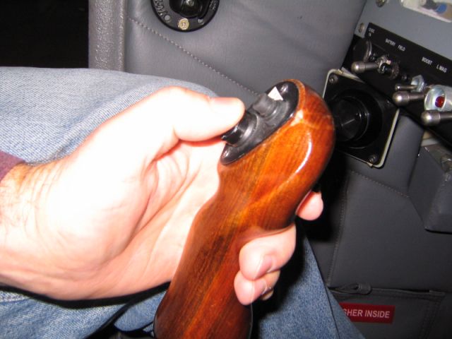

<![if !supportLists]><![endif]><![if !supportLists]><![endif]><![if !supportLists]><![endif]><![if !supportLists]><![endif]><![if !supportLists]><![endif]><![if !supportLists]><![endif]> I used Van's wood grips because I think the wood looks kind of classy, in moderation.
I put their PTT in front, AP disconnect and Van's trim on top in the supplied cover plate.
After about a year I had lost both little button caps on top of the AP disconnects. Vans sells a rubber cap replacement for about $9 that works well. I looked all over the place for a better price but no joy. Seemed like a pretty simple part, especially here close to Silcone Valley. Not.
I wish I had put the trim switch in a different part of the grip cover. Where the trim is now, it takes two hands to fly and trim on take-off if my left thumb is trimming nose down. With my left hand on the grip and the stick needing forward pressure, my left thumb rises too high to push on the back part of the grip, so I have to resort to pushing with my right hand while lefty does the trimming. I've learned to be very careful to get the trim right before take-off, but a few of the first departures were interesting.
On a recent customer's RV8, we installed Vans grips and trim switch, but this time with the trim switch near the top of the cover plate, where my AP disconnect is located. That works much better.
I couldn't bear to use the 2-lb. (OK, maybe 5 oz.) steel collar supplied with Van's grips. I got a similar aluminum part from McMaster. For $160 I think Vans should spring for the lighter part .
