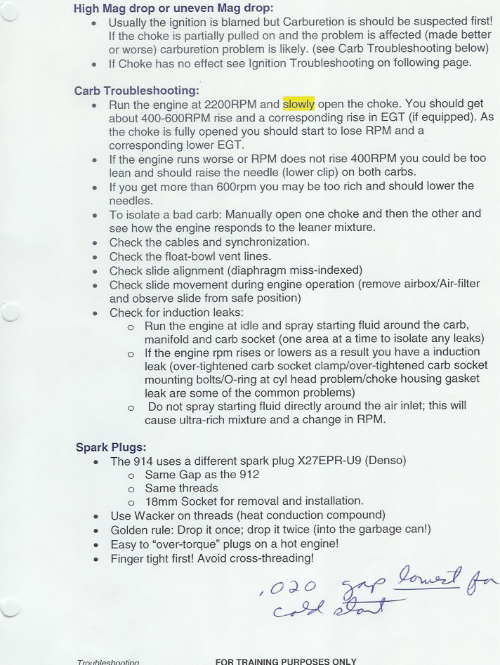

This is from my trouble shooting manual I received at a course I took from Rotax, pretty good stuff, hope it helps.

PostPosted: Fri Feb 27, 2009 1:57 pm    Post subject: Rotax mag drop Reply with quote
Hi Jerry,
"This is from my trouble shooting manual I received at a course I took from Rotax, pretty good stuff, hope it helps."
Many thanks for this, it looks really helpful, but I only got the first page on carb troubleshooting, and not the second page on ignition troubleshooting. Could you please send that too?
