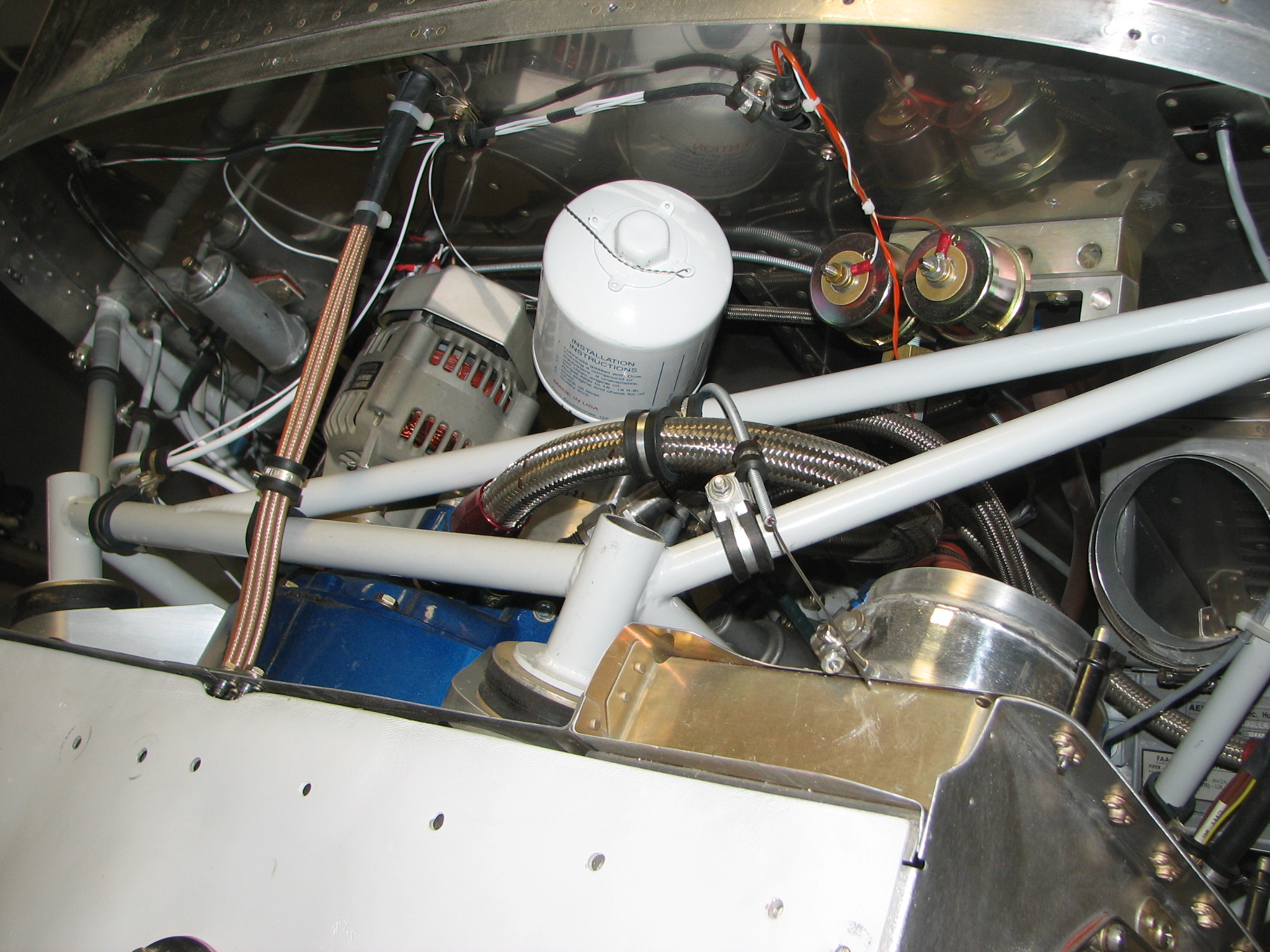

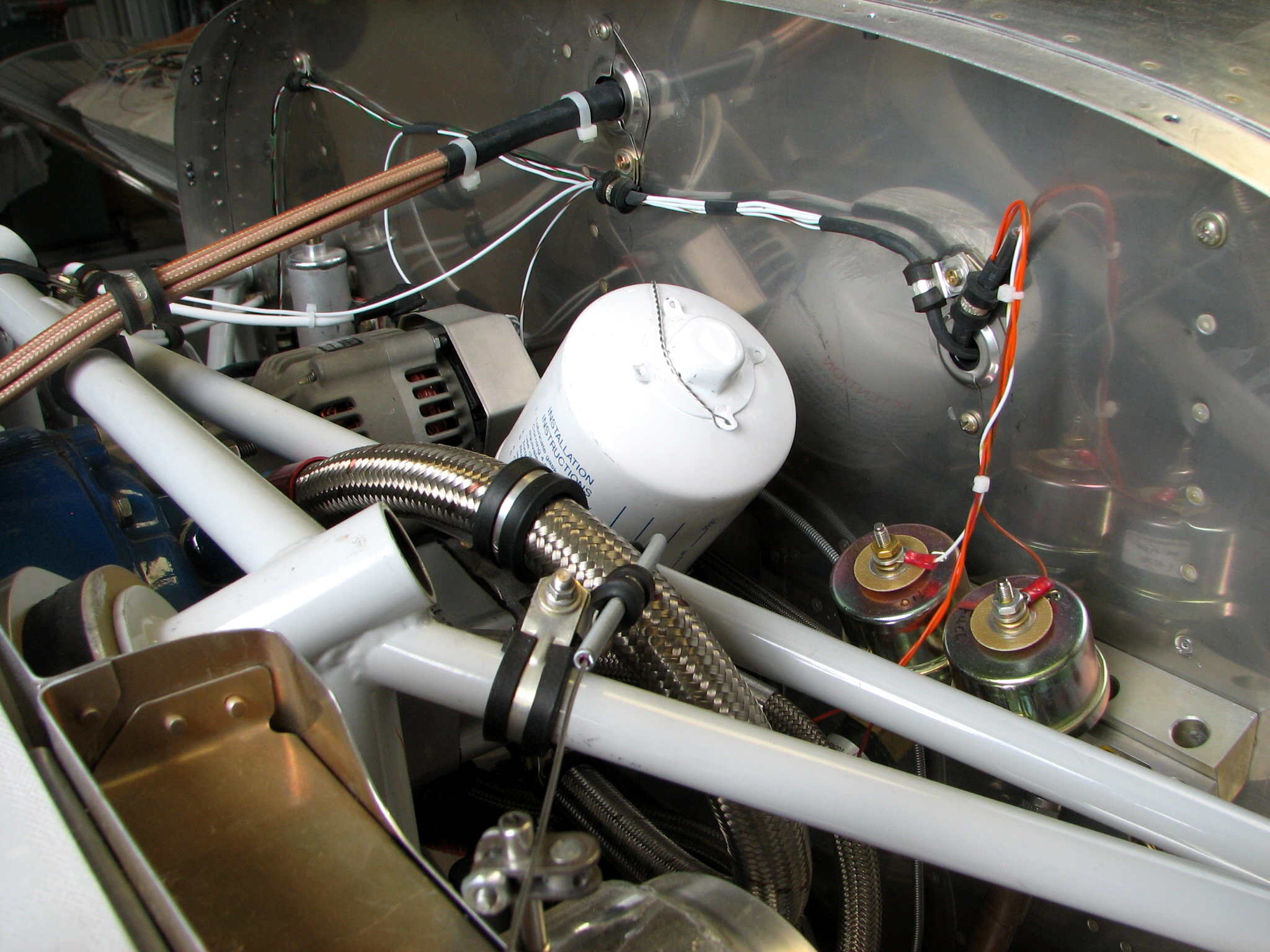

Hello
I just thought wanted to get some feedback how/if you bundled the wires /cables and tubes going through the firewall.
Here is the list of things which need to cross the firewall.
1) Throttle cable
2) Prop cable
3) Mixture cable
4) Alt air cable
5) Heater cable front
6) Heater cable rear
7) LSE Plasma III input cable
Cool LSE ignition cables (3x)
9) Battery cable
10) Fuel pressure cable
11) Oil pressure cable
12) Manifold pressure tube
13) Oil temperature cable
14) CHT cables (6x)
15) EGT cables (6x)
16) Brake fluid container
Does anyone have a picture of how and where they did the firewall penetrations?
Cheers
Michael

I really don't have any great shots of waht you want.... but I can shoot some tomorrow. Fo any explainations, let's arrange a time that both of us are looking at the same pics.
What time zone are you in? My number is 916-801-8402. Evenings 6-11 best for me.

We all have different configurations except for the - Throttle, Mix, prop and alt air cables (and the manifold pressure sensor). As stated previously, I feel that the stainless steel heater valves are a mandatory option for fire safety. The eye ball openings are probably the best way to go for max fire safety, but they are verrrrry expensive. I am opting to use a high quality fire block caulk and nylon openings
I have a bunch of pictures that I will send to anyone who contacts me off line. I took them at OSH '08. They are too large to post (1.5-2 meg)
Just a suggestion to the newbies here - if you go to OSH take a LOT of pictures of the RV10's there. I took 300 pics last year and they have been invaluable in finishing my project

Don, question? In the second picture, looks like you have a plenum over your engine. I am looking at ways of improving my airflow have considered making my own but….not sure the best way of doing it. I have two general questions. 1. Considering the heat (after engine shutdown), what materials are best to use. 2. How does the front of the plenum interface with the upper cowl.
I have never been happy with the baffle seals and think that is part of my oil temp problem in the summer. I would love to do away with them and go with a plenum. I have considered just building a fiberglass one, but considering how much closer it will be to the engine (than the cowl) I am worried about it being destroyed by the heat.
Any great ideas out there?
