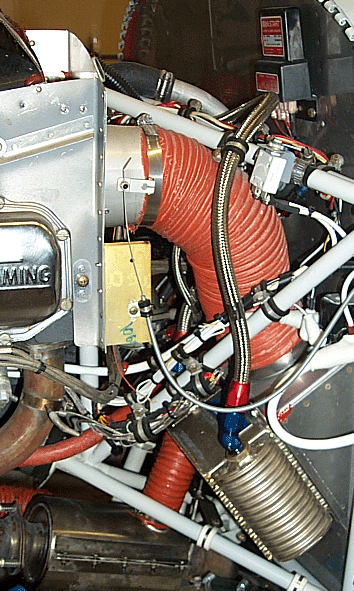

PostPosted: Sun Feb 22, 2009 12:11 pm    Post subject: How many push pull contol cables (cabin heat type) Reply with quote
Here is a picture of the new cooler….looks just like the old cooler and the air controller….
Rene'

PostPosted: Sun Feb 22, 2009 1:34 pm    Post subject: How many push pull contol cables (cabin heat type) Reply with quote
Rene', the replaceent cooler just bolts on to the same place as the original Vans cooler?
Pat

PostPosted: Sun Feb 22, 2009 2:14 pm    Post subject: How many push pull contol cables (cabin heat type) Reply with quote
Yep, it is the same form factor, just has more fins inside.  I will not know until this summer how much it helped the oil temp.
It only took about 10 minutes to change it out.  If anyone wants a stock cooler cheap….I got one.
