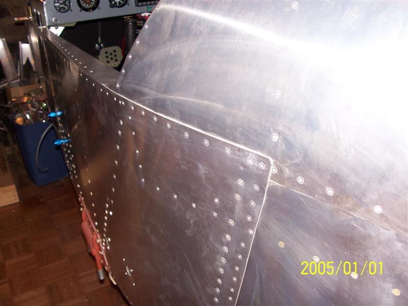

Randy,
I've dimpled my skins. I didn't really like the idea of the Zenith flush rivets pulled into a raised head, though I'm sure they are fine. I have to disagree with the idea that dimpling somehow distorts the skin. I haven't had that problem at all. I did the majority of the dimpling with a home made riveting tool. I'm plans building, so once I've done all the work of laying out, cutting, drilling and deburring the part, the little bit of extra time dimpling is no big deal. I didn't really do mine for any performance gain as I believe that would be negligible. I did it for looks. I like the idea of washing a smooth surface.
You're right about the clecos, there's no such thing as too many. To see the hand made riveting tool check out my website at http://daniel.dempseyfamily.us/zodiac/index.html
Dan
"lusc10(at)sbcglobal.net"]Has anybody built a CH 601 or 650 out of 2024 t3? Also has anybody dimpled skins to get a flush outside skin. I hear that the sonex has a dimpled skin option. Thank you for time.
Randy
PS anybody have clecos? Looks like I will need a lot.
This picture shows some of the flush rivets.
