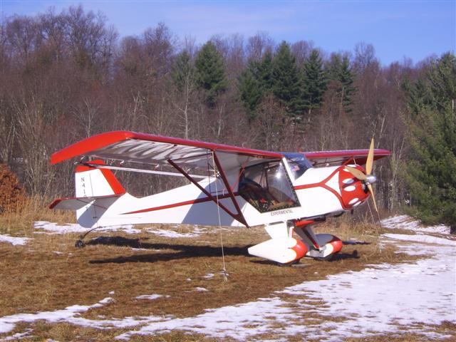

where do I get your pics at I,ll send you 1 of mine

yes I have found them. That is a very,very nice plane,I love that yellow,
