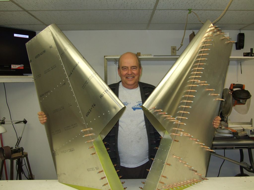

PostPosted: Mon Feb 16, 2009 3:52 am    Post subject: Rudder Reply with quote
Joe,
I am in exact same position as you are, and was told by the factory that they are identical. However as almost all the .016 mil aluminum that is seen in the 701, is being replaced with .020 thou in the 750, I made both my rudders in .020 thou.
Shirley from Zenith confirmed that my plans for the 750 were sent out Airmail last Tuesday, and I am expecting then in today, so I will confirm the build details, size, and thickness of the materials used as soon as they come in.
Robert the 701 & 750 Scratch
