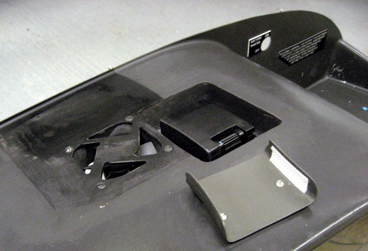

g-iani(at)ntlworld.com
PostPosted: Sun Feb 15, 2009 3:05 am    Post subject: Windscreen Demister Reply with quote
A small computer fan works well. See attached, The recessed aerial is for my Skymap IIIc and mount is for my PCAS unit.
Ian Rickard G-IANI XS Trigear, 200 hours
Europa Club Mods Rep (Trigear)
e-mail mods(at)europaclub.org.uk
or direct g-iani(at)ntlworld.com
 Filesize:  167.46 KB
 Viewed:  3540 Time(s)

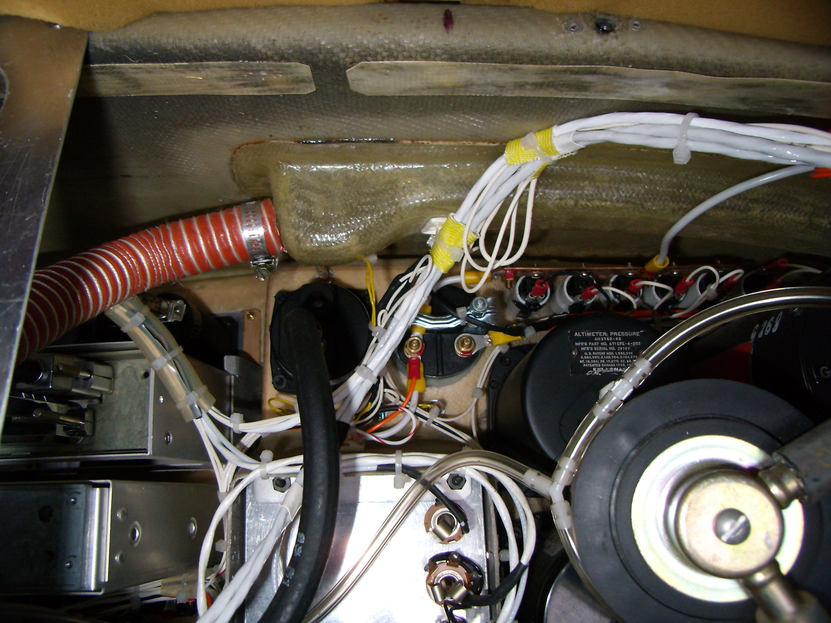

air.guerner(at)orange.fr
PostPosted: Sun Feb 15, 2009 3:49 am    Post subject: Windscreen Demister Reply with quote
Graham,
I have installed a demisting system using a glassfiber plenum under the top of panel module (see attached picture). Hot air comes from the heating system which takes air behind the radiator and exits through 6 holes (7 millimeters diameter) at the bottom of the windscreen. It works well in flight but is not very effective on the ground were it is the most needed. A fan would certainly help for ground use.
Hope that helps.
Remi Guerner
F-PGKL
