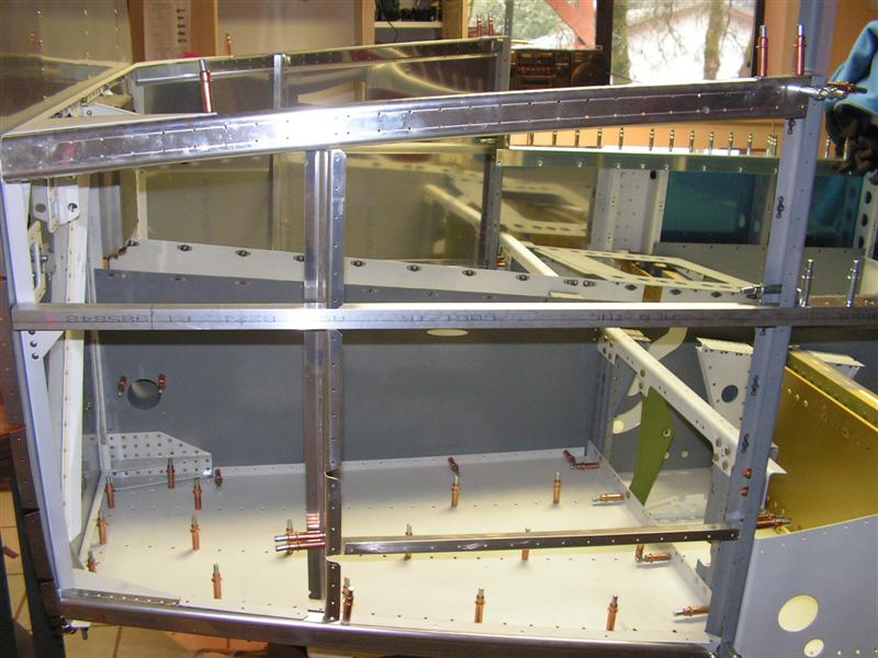

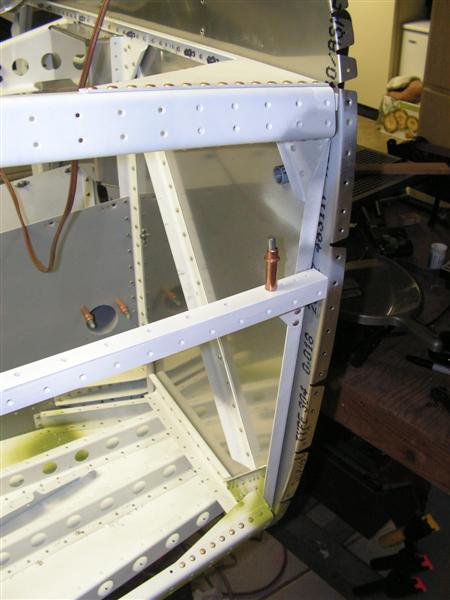

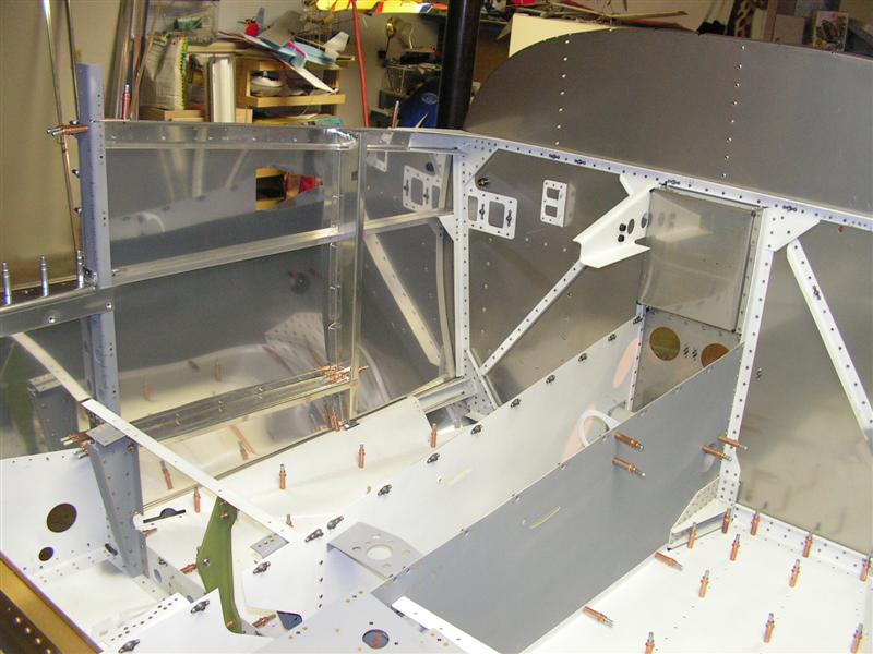

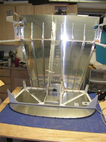

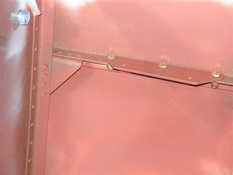

PostPosted: Sat Feb 14, 2009 7:45 pm    Post subject: Engine ground on RV 10 Reply with quote
Bob C
You asked for some pictures of the RV 10 floor boards.
Just a note C In one of the photos there is a nice heavy 3/4" angle that runs in the side wall of the aircraft for the full length (there is a splice in it back behind the baggage door.) Van's has said not to drill any additional holes in this piece C however there is a plate mount with three AN 3 bolts that hold the rudder pedal blocks (it's visible in the photo labeled SYS 010.) Maybe this would be a good place to ground the firewall ground forest?
Of course C I though about this after pulling a #2 ground up from the battery yesterday!
Hope this is of help C
Vern Smith ( #324 RV-10 finishing)
