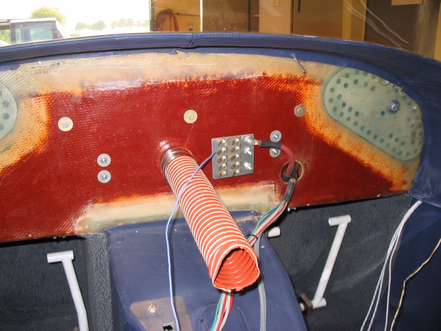

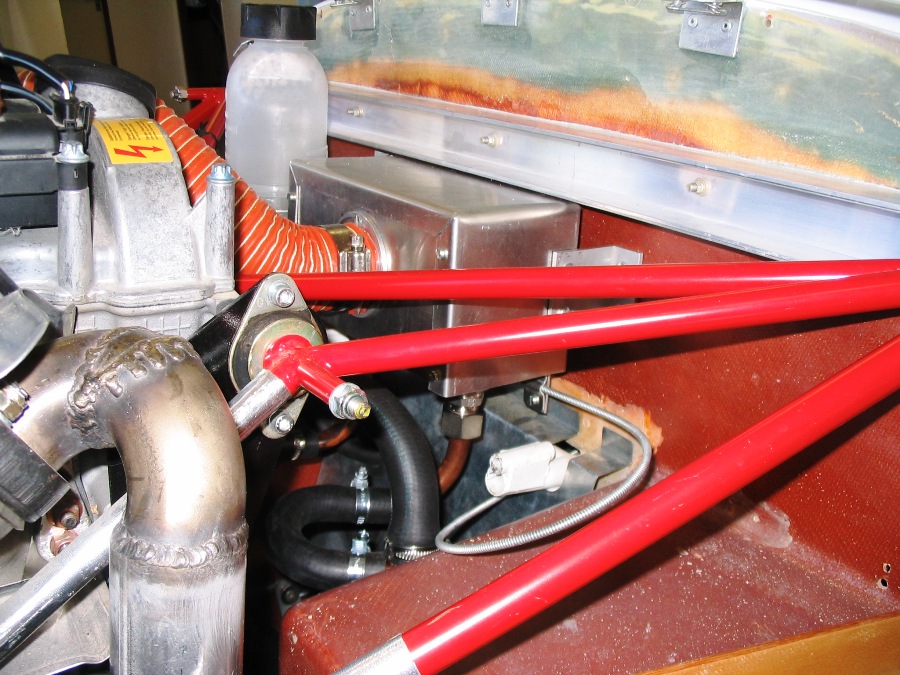

I have made some small slots (12) into the instrument panel module (about 3x15 mm) and inside of that panel a tunnel cover with a 2” tube end for the silicone rubber hose. My heat exchanger box (fresh air from cowling front inlet with 2” silicone rubber tube) is using hot water from the engine, running through light weight oil cooler.
A flap inside the firewall, operating by a bowden cable, opens or closes the warm air.
Please see attached picture.
