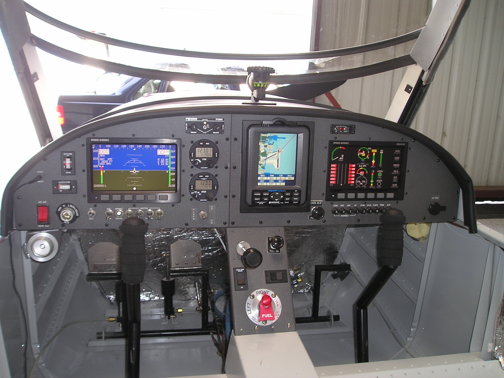

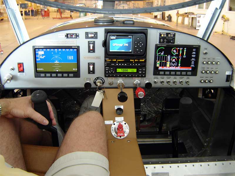

PostPosted: Wed Feb 11, 2009 7:55 pm    Post subject: IFR Qualifications Reply with quote
There is plenty of room in a 601’s panel for two EFIS and at least two manufacturers (Dynon and MGL) support dedicated back-up batteries for their units. Complete redundancy at a reasonable price is quite doable. Pictures of example panels attached.
-- Craig

5
6
7
8
9
 Filesize:  59.21 KB
 Viewed:  16823 Time(s)
 Filesize:  627.95 KB

PostPosted: Wed Feb 11, 2009 11:00 pm    Post subject: IFR Qualifications Reply with quote
The 5.7 inch (diagonal) MGL unit (“Enigma”) is $2,350. But it is also an HSI display for your NAV radio, a moving map GPS and the engine monitor (and autopilot if you wish). You still need the magnetic and gyro sensors ($240 and $950, respectively) but they can be shared if you don’t want complete redundancy. And the box that mounts FWF to read engine sensors is $195. But for a completely redundant system the price is
2 Enigma $4700
2 sensors packages $1190
1 engine pod $195
TOTAL $6085
So what’s the price of a 6 pack of steam gauges (good quality, not Chinese imports), a good compass, a moving map GPS and engine instruments? Now compare the relative reliability of the two: both the reliability of the individual components and the overall reliability of the system. How much does the system degrade when a component fails? With the 6 pack loose a gauge and you are left inferring the lost data from the remaining instruments. Loose one of two EFIS and you have the same information.
Also place a value on increased situational awareness. Things like “highway in the sky”, fuel flow, the direct display of density altitude, wind direction, AOA, voice alarms when engine measurements go out of spec, etc.
Of course I understand the downside of losing one EFIS. That’s why my original response described dual units. For maximum reliability buy two different brands of EFIS – that insulates you from seeing the same bug on both displays.
-- Craig
