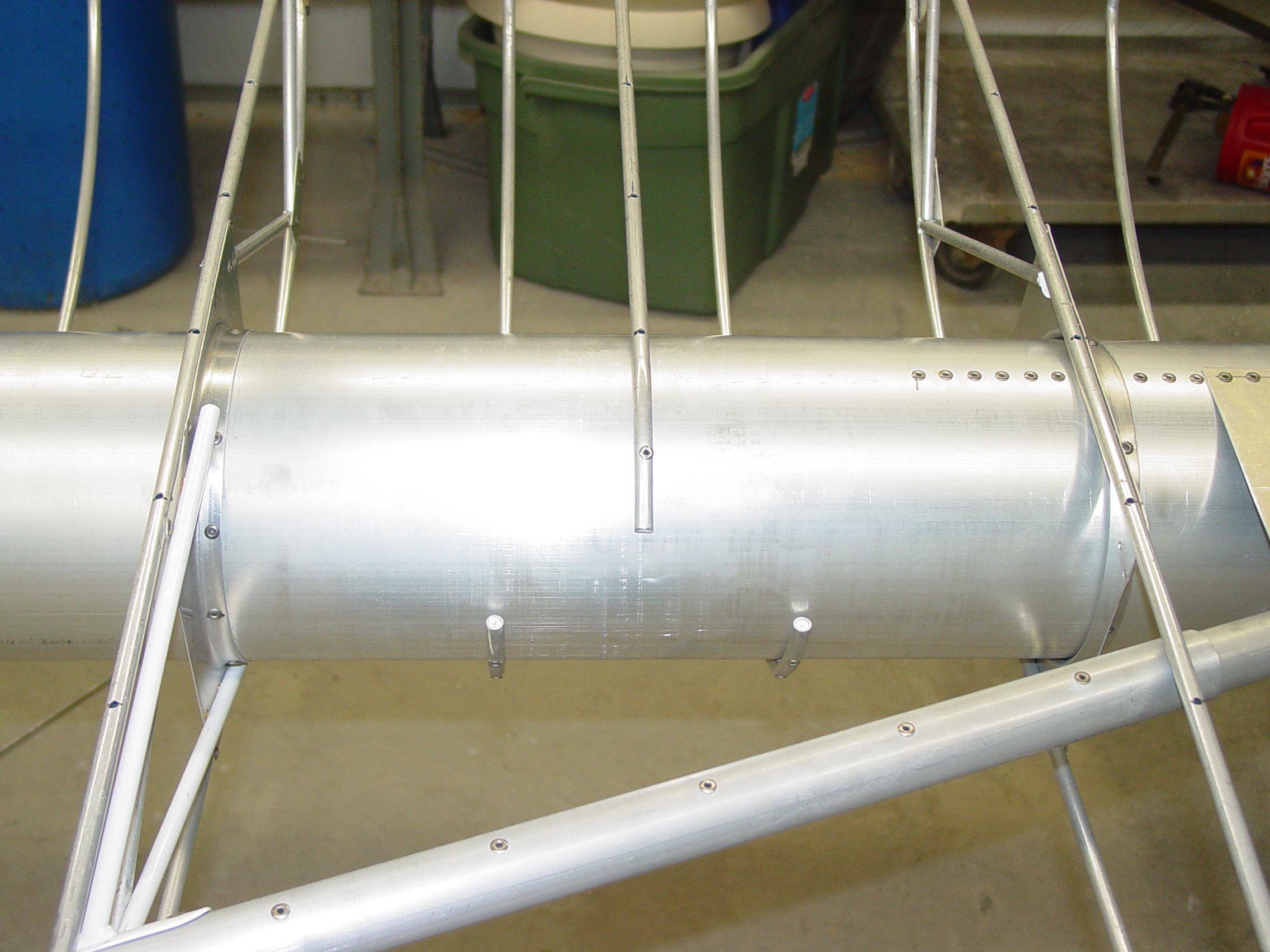

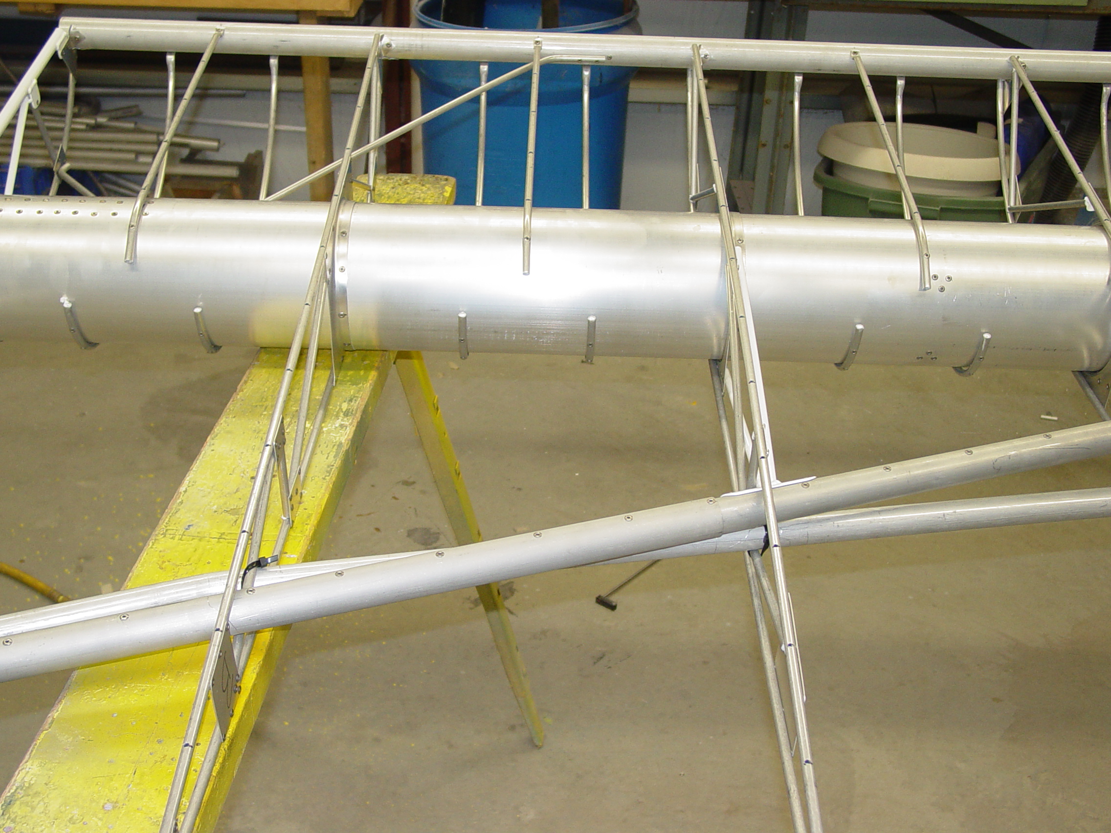

I am attaching two pictures of how Brian, at Kolb factory, handles the loose pieces that may remain in the tubes. He probably blows the tubes out first then he seals all the ends as show in the pictures. Silicone rubber would probably be good to use here.
