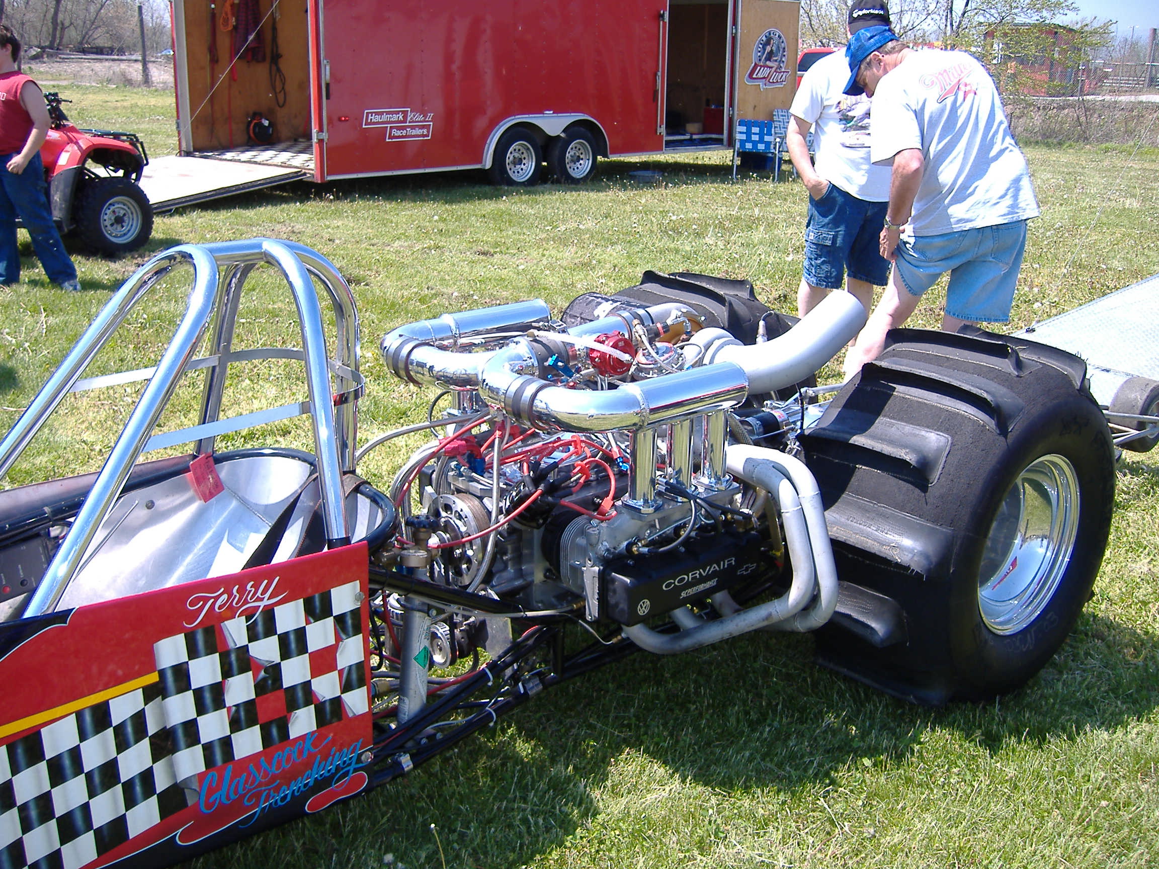

The Aircraft community is by no means on the cutting edge of Corvair development. The race car guys have been pushing this engine to its ragged edge for some years now. I know of one Corvair (Sand-Dragster) that is putting out some where near 750 HP on Nitro Methane & 40 - 45 pounds of boost.
When the Dragsters owner told me this I just laughed at him.
I thought he was crazy and was trying to BS me.
Boy was I surprised!
Obviously this guy has broken some engines & granted it's a Dragster.
Here's a picture of it.
My point is that none of our engines are even going to come close to half that. Especially because we can only turn them up to about 3500 rpm before the prop tips go mach.
So reaching the engines structural limits with less than 200 HP at less than 4000 RPM is not some thing I am overly concerned about.
