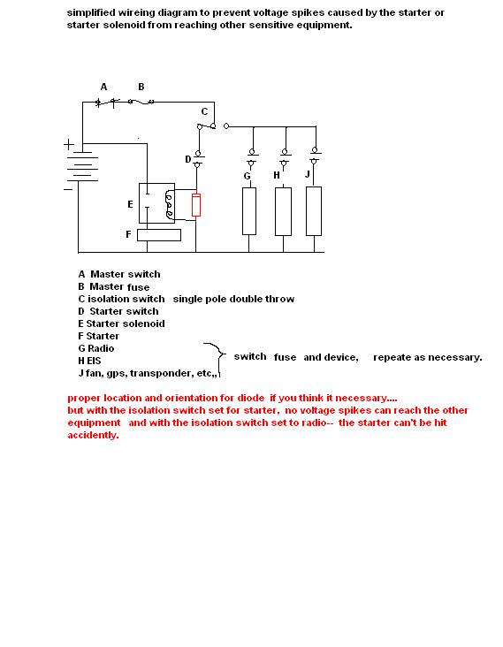

Rick
this is how I approached the problem... it seems to be fail safe and easy. I did not use the diode but I showed it in the diagram to show proper placement.
Boyd

PostPosted: Mon Feb 09, 2009 4:01 pm    Post subject: Re: diode on a starter solenoid Reply with quote
Boyd:
The way you have your system wired is perfect isolation so much so that the diode is not needed at all to protect the electronics. The diode is however still needed to protect the starter switch contacts. The contacts can actually pit without it. Good job, I'll be using your idea in my plane.
