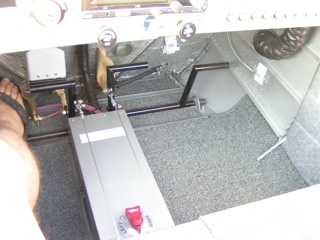

Here's what I did. I ran all of the electrics, brakes, and fuel lines through the little tunnel......Fred
