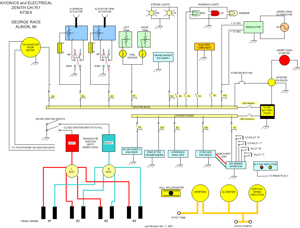

Attached is the schematic diagram of what I did building a CH-701
It is in picture format. I have it in DWG and DXF if it would be of any help.
Diagram was drawn using Microsoft Visio.
George

PostPosted: Thu Feb 26, 2009 5:34 am    Post subject: Fuses /Breakers and a few electrical questions Reply with quote
George,
Excellent picture. Excellent design.
