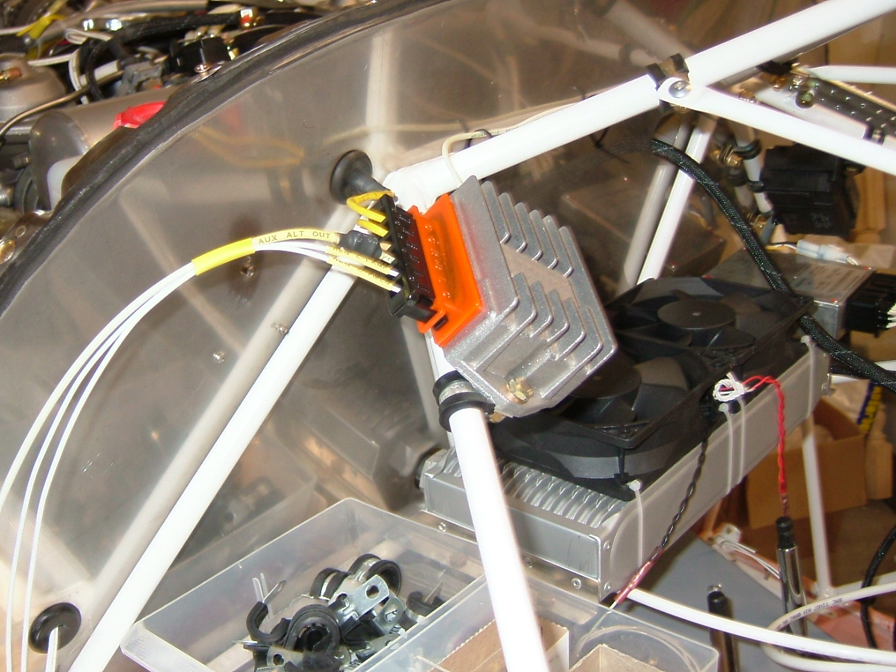

The standard cabin heat for the 912 series is a heater core with two big CPU fans on top. This is how mine is done and it works very well. I have a coolant shut-off valve on it so I can turn it off in the summer and not have the hot coolant running through the core. Here is a pic of the setup as installed per factory instructions. Not the best angle but you'll get the idea.

My brothers KF II has the stock heater core and PC fan in it. It will get the temps 15-20 deg above ambient on a good day. The heat muff gives alot better heat, and is lighter. Mine had big heater core in it with dual fans when I bought it, but the dang thing was over 5 pounds. I under a pound in my new heat system with better heating.
