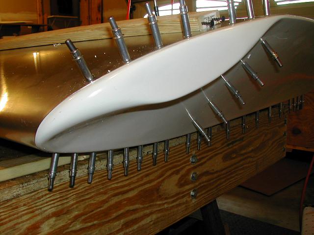

Jim, I finished installing the new style wing tips a couple of months ago. At that time, I don't think there was any print or write ups on it. I also talked to Caleb about the installation. One thing I knew for a fact was, fiberglass doesn't usually hold it's molded shape unless it is thick and/or strongly reinforced. Of course, these wing tips are not thick by any stretch of the imagination and mine didn't hold their original shape either. If you have trouble with the parts not lining up or a flat edge not being so flat, use a heat gun on it as I did. Stay back from the part and heat it up slowly. Gently over pull it to where you want it to be then hold it there. Be sure to use a shop towel because its going to be hot. Don't overstress it, otherwise it WILL crack!! When it cools, it should shrink back some and will be hopefully exactly where you need it to be.
One other thing I did was, I cut an "L" angle and reinforced the wingtip inside the wing. I "sandwiched" the bottom of the wingtip between the bottom skin and the "L" angle (on top). It worked like a charm - I got a nice, straight edge.
My EAA Advisor/DAR suggested I also chalk around the entire wingtip. I bought a tube of Dupont 7500 chalk at my local auto paint store. It's water soluble and can be cleaned off with soap and water. It can be painted.
Hope this helps you out.
One fiberglass wingtip drilled and clecoed into place
