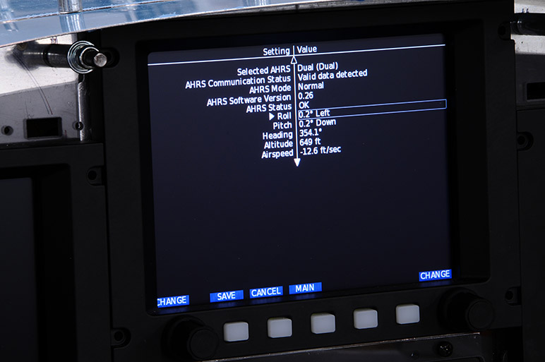

PostPosted: Wed Feb 11, 2009 10:42 am    Post subject: Re: GRT AHRS Pitch & Roll Calibration... Reply with quote
Thanks for the feedback. I also heard back from GRT tech support and they said that anything under .5 degrees is fine. I'm right around .2 degrees in both pitch and roll, so I guess that's close enough.
Matt
Pitch and Roll at .2 Degrees
 Filesize:  86.87 KB
 Viewed:  796 Time(s)

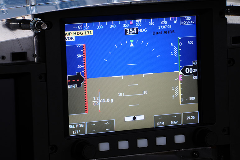

PostPosted: Wed Feb 11, 2009 10:46 am    Post subject: Re: GRT AHRS Pitch & Roll Calibration... Reply with quote
Here's one more shot to prove it looks alright at .2degrees... Smile
Matt
Level to .2 Degrees
 Filesize:  111.27 KB
 Viewed:  5504 Time(s)
