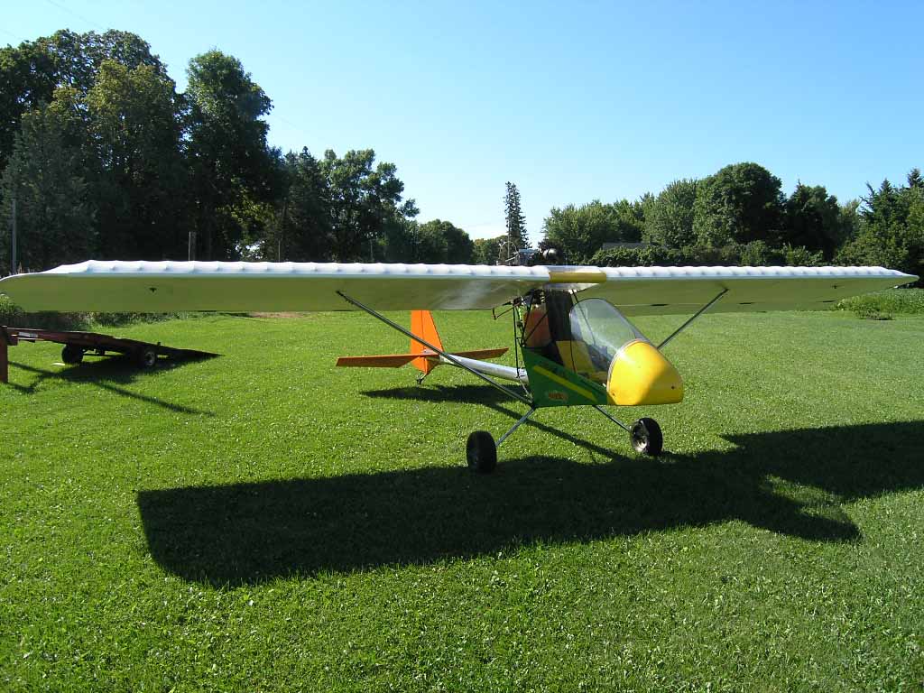

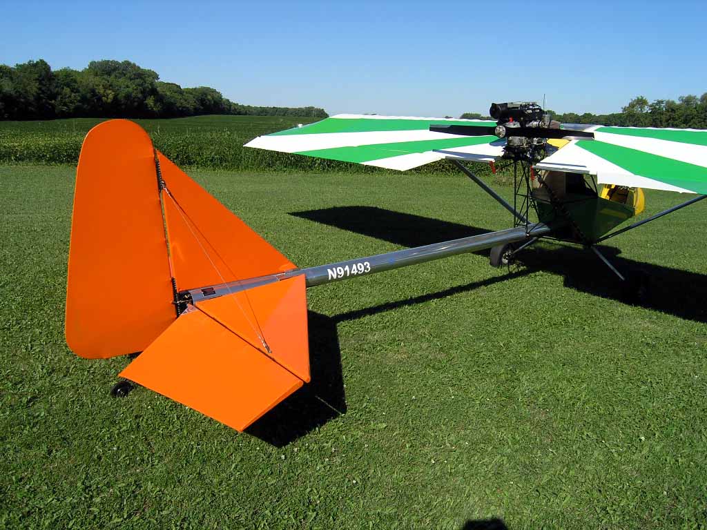

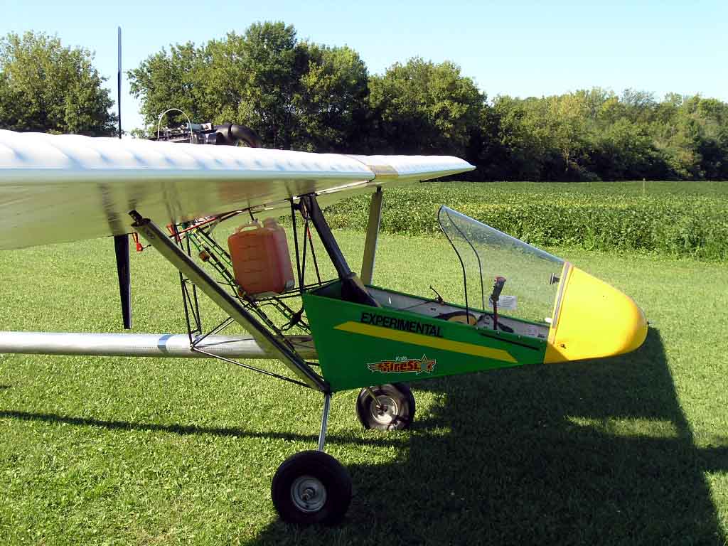

Richard, my Original Firestar is 319lbs empty with a 447 engine. I listed it with a gross weight of 650lb. Here are some pictures and my weight and balance sheet.
