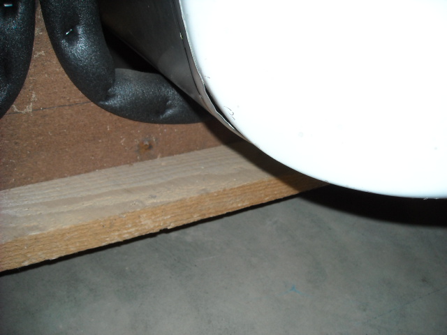

I built my outboards 3 years ago and was so disappointed with my tips I was ready to commit hari-kari. The gap between the aluminum leading edge and the fiberglass tip is what I'm talking about. The wing's in a cradle- took the picture laying on my side. The tips haven't been riveted yet, so the gap might decrease.
No matter the severity- what filler's going to have the best chance of staying put?

That does not look that foreboding. There is, also, a filler that has fiberglass strands in the mix. It is used just like Bondo or any of the other fillers, except it is a little tougher. If you use this, you should apply it by spreading it in one direction only, so as to "line up" the fibers for more strength. At least that is what I was told/ Seems to work pretty good. That area in your picture is not even close to being a moving or flexing part, so any of the fillers would probably do just fine. Just be sure to get it as smooth as you want the finished look. Any scratches will show in the final finish.
Rick

I think I have some of the stuff you're talking about, and if you don't get it right the first time it's stuck, and you're stuck because you can't sand it.
