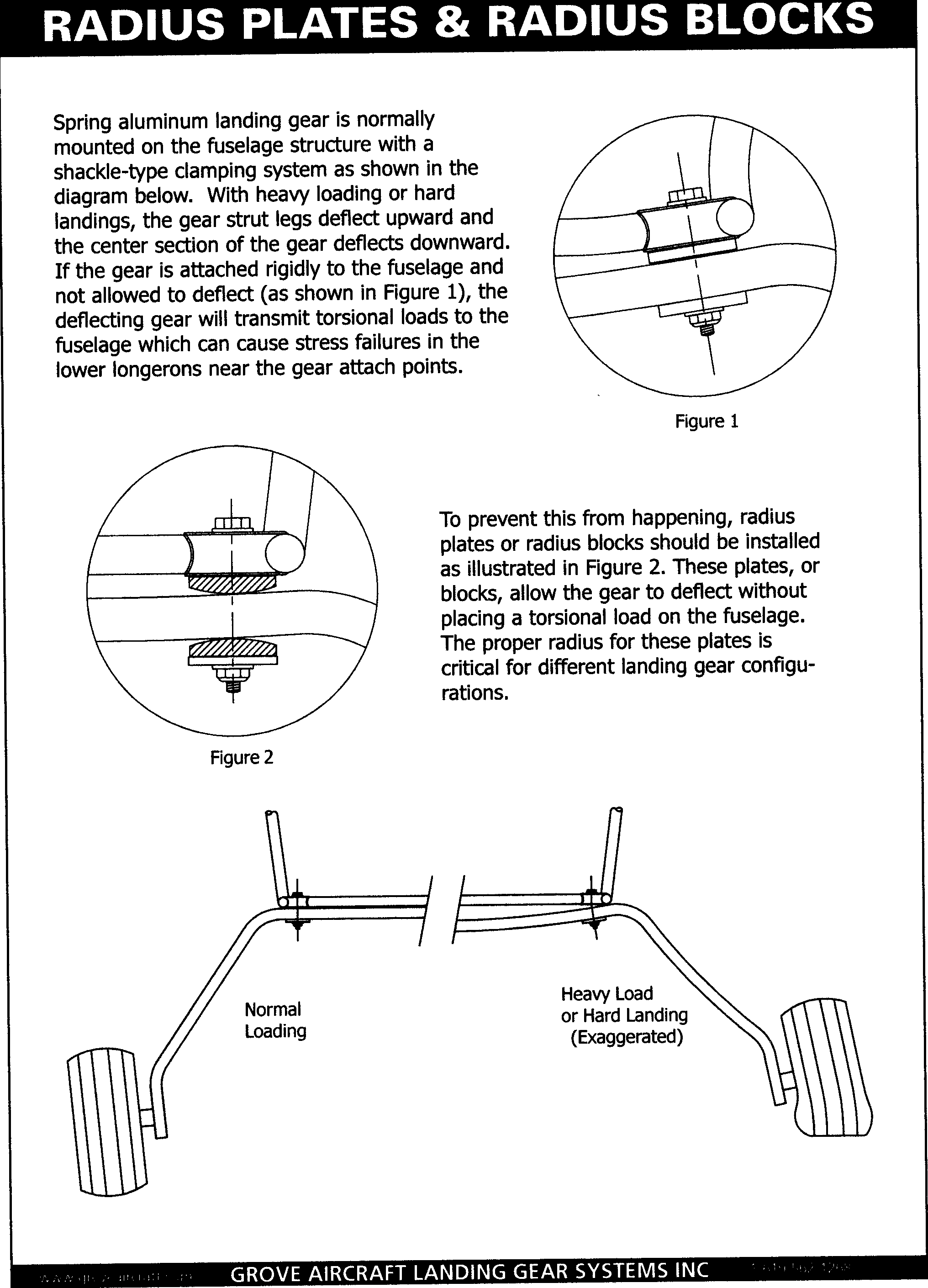

RADIUS PLATES & RADIUS BLOCKS for Grove U/C any comments!!!! Cheers T87

Radius plates are a good idea because they help alleviate the twisting of the bottom fuselage longerons. You can call Zenair in Canada and order the set that is used on the AMD 601 with grove gear.
