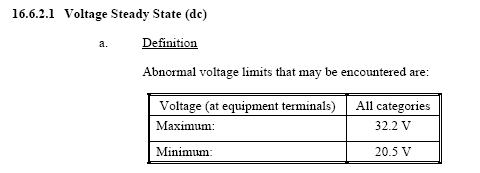

Aha! A number. Okay, until we're offered different
values, we can work with the idea that DO-160 upper
operating voltage limits for 28v systems apply here . . .
[img]cid:.0[/img]
For this reason it is mandatory that all aircraft using Plasma CD Ignitions are equipped with over-voltage protection in their alternator charging system(s). Over-voltage is a requirement for certified aircraft.
. . . yes.

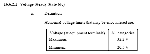

. . . yes.

Summary:
If the ov trip on these systems is equal to or greater
than 32.2 volts, then installation in a 14v system
with switches and fuses should be no big deal. This
ASSUMES that the crowbar ov protection system has
no parasitic trip modes. We've encountered this
phenomenon a couple of times and instituted design
changes to mitigate the problems as they were
discovered.
