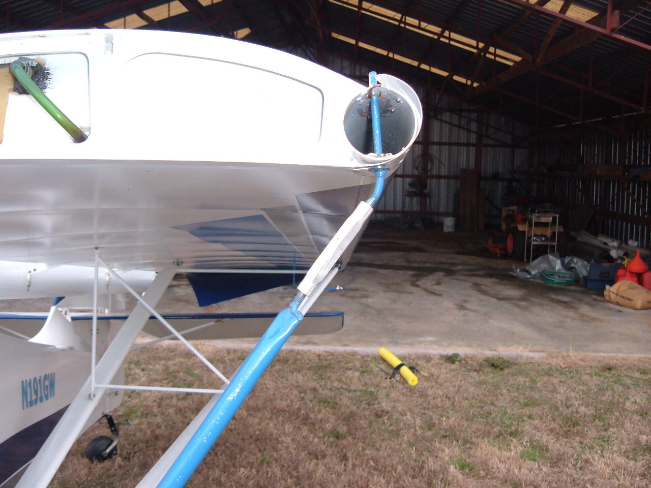

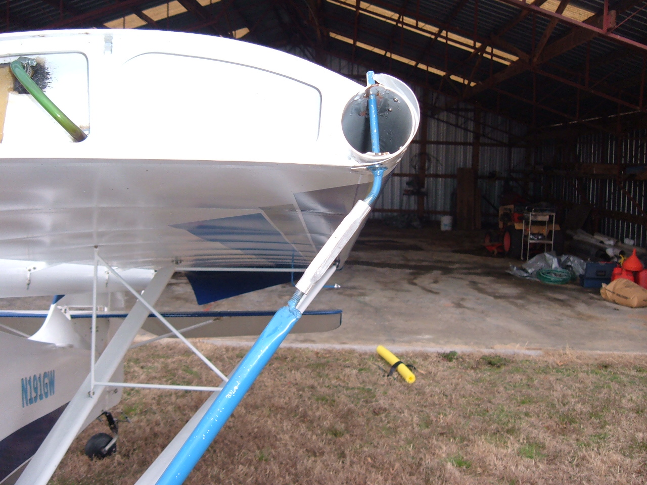

These are made from 3/4 X forty nine and one half inch long rigid electrical conduit. You can fabricate them on site to fit the plane when you load it if you have a drill and a hammer.
Zoom in on the picture to see there is a slight bend on the lower end and a small piece of rubber belting to cushion between the support and the wing spar on the top end.
edited to correct conduit size. tj

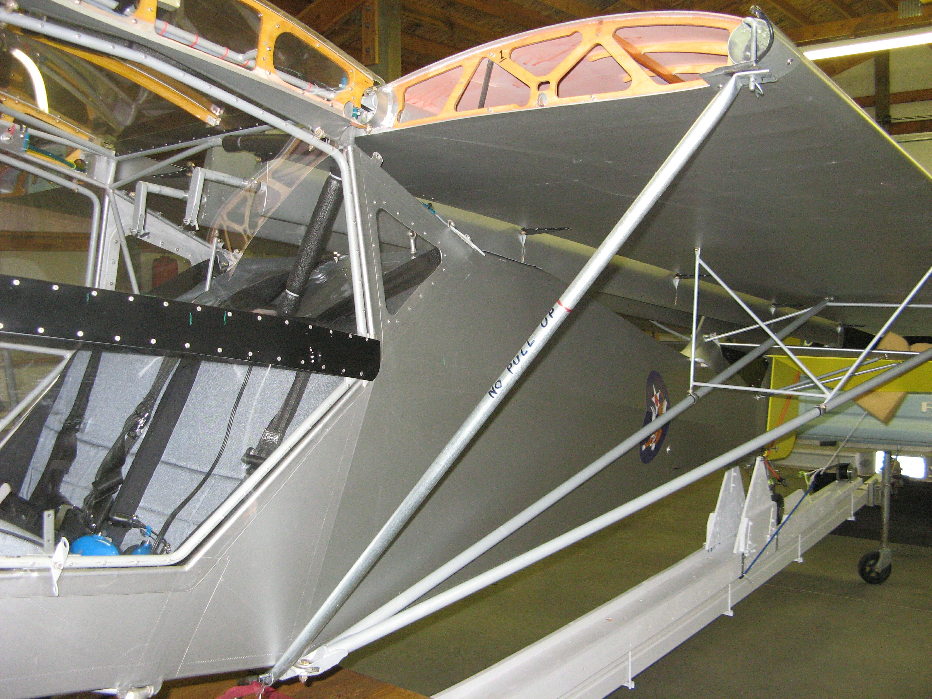

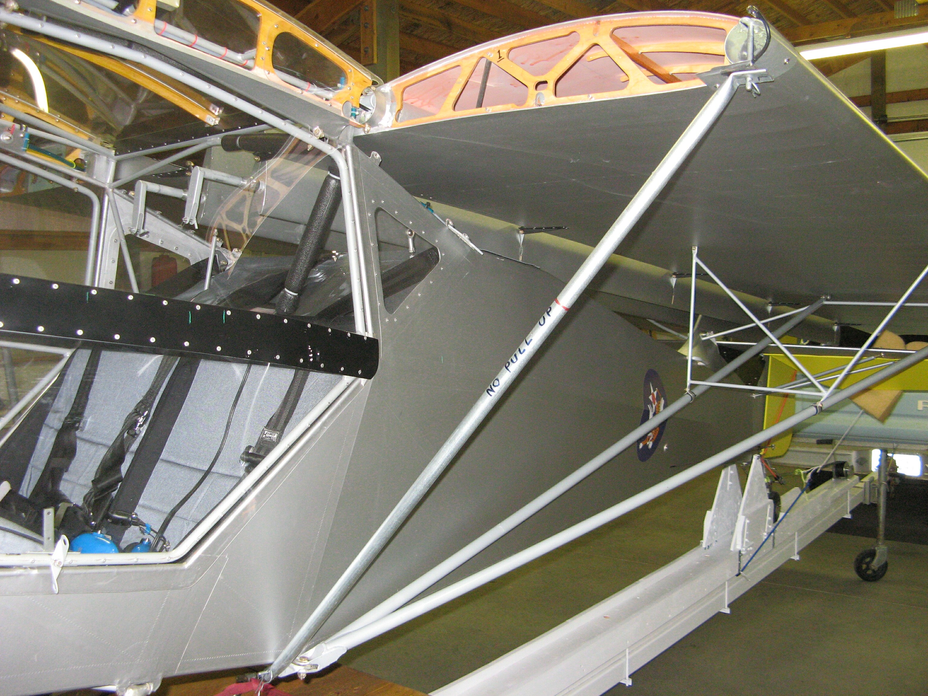

 Filesize:  469.45 KB
 Viewed:  728 Time(s)

I'd suggest using a bolt through the spar with a "crush tube" made of
steel pipe or tube, rounded on the ends to match the radius of the
tube, thus insuring that you don't crush the spar when tightening the
bolt.

Any idea how long each of those pins was?
James, the pins are both 4 inches long. The bottom one is 1/4 inch diameter and the top one is 5/16. I made them by cutting the threaded part off of longer bolts. If you use a bolt on the spar, 3 inches of smooth bolt shaft will get through the spar so no threads are rubbing on the spar or spar doubler. You can use a little longer bolt and washers to space between the spar and the double nut.
Tighten the first nut finger tight then hold it with a wrench while you tighten the lock nut. Bolts will work for a one time installation and removal. Be careful putting the threaded bolts in or taking them out of the spar as the threads can waller out the fittings, they are soft steel.
