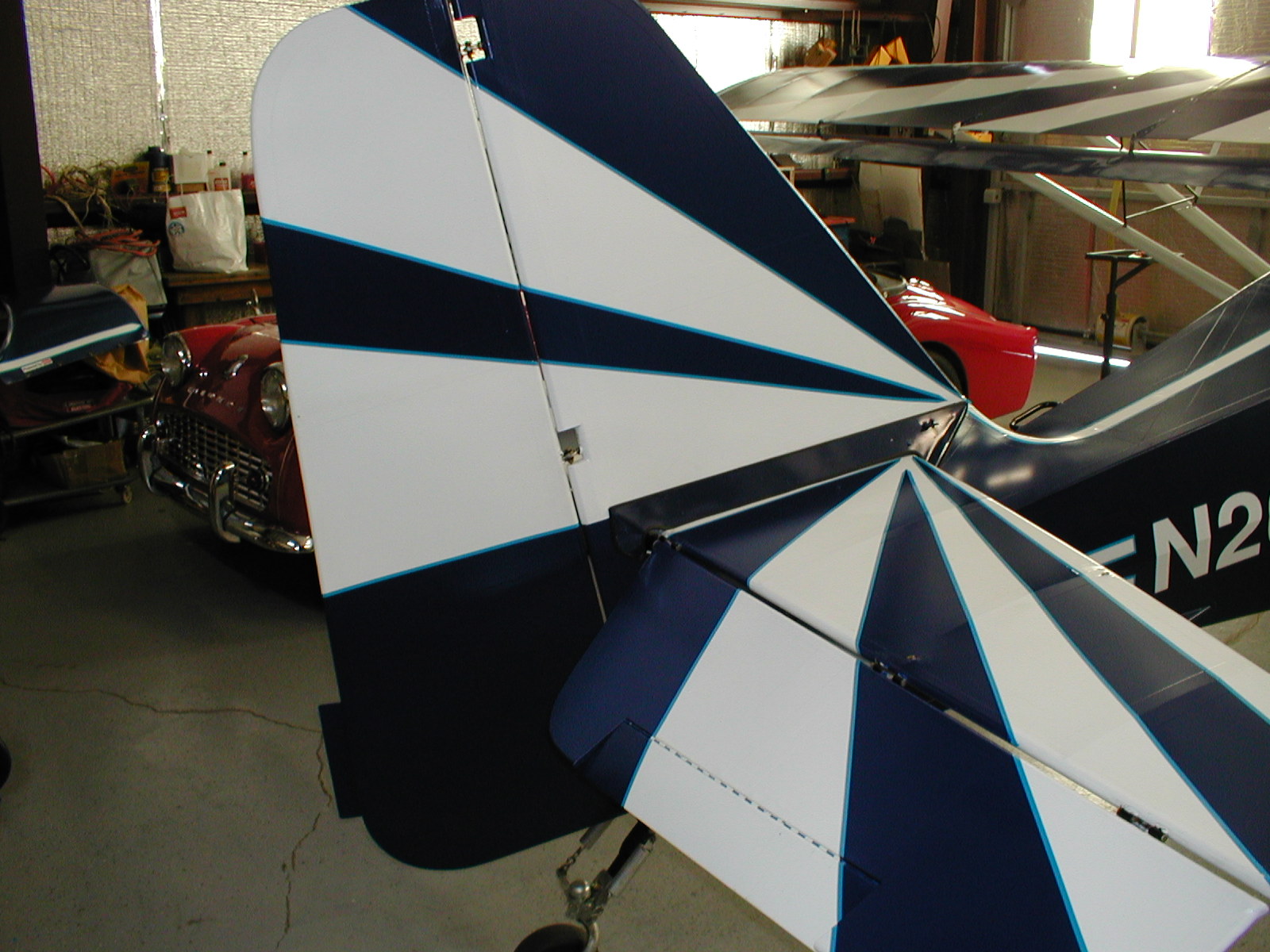

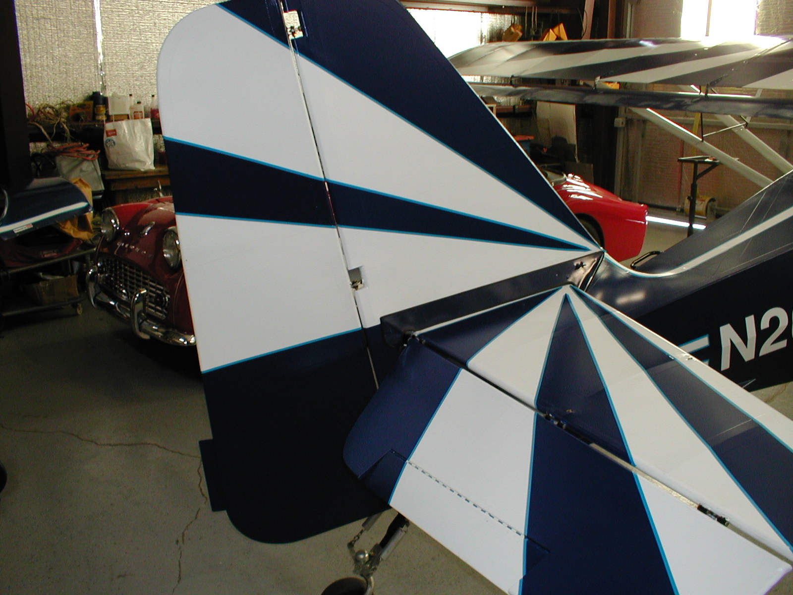

Noel,
If you are gap sealing your rudder,John McBean has a very nice contoured hard foam for that purpose. I bought some of it and glued it to the horizontal stab then covered it with 6 inch polyfiber tape. I painted it and it looks nice .
