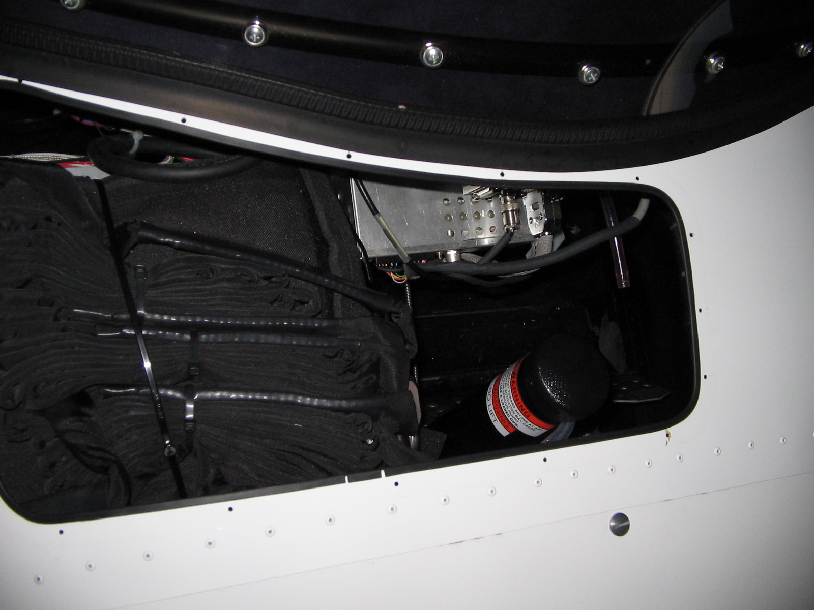

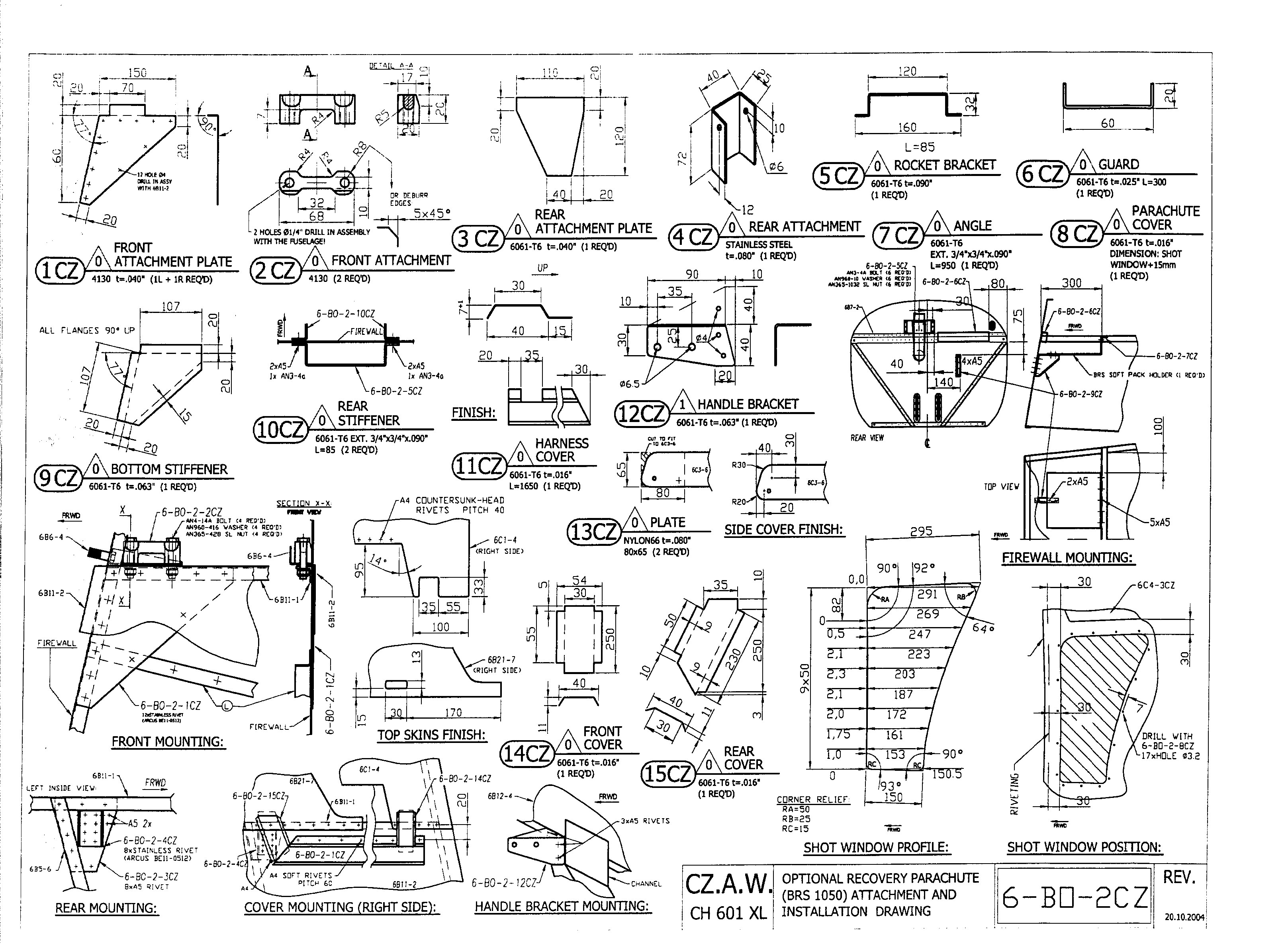

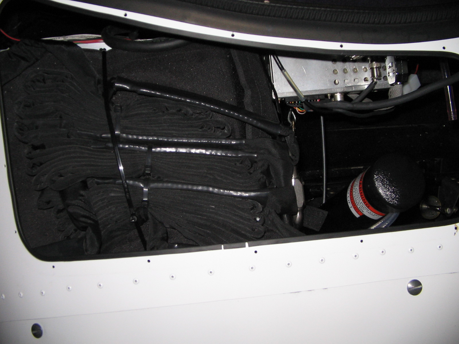

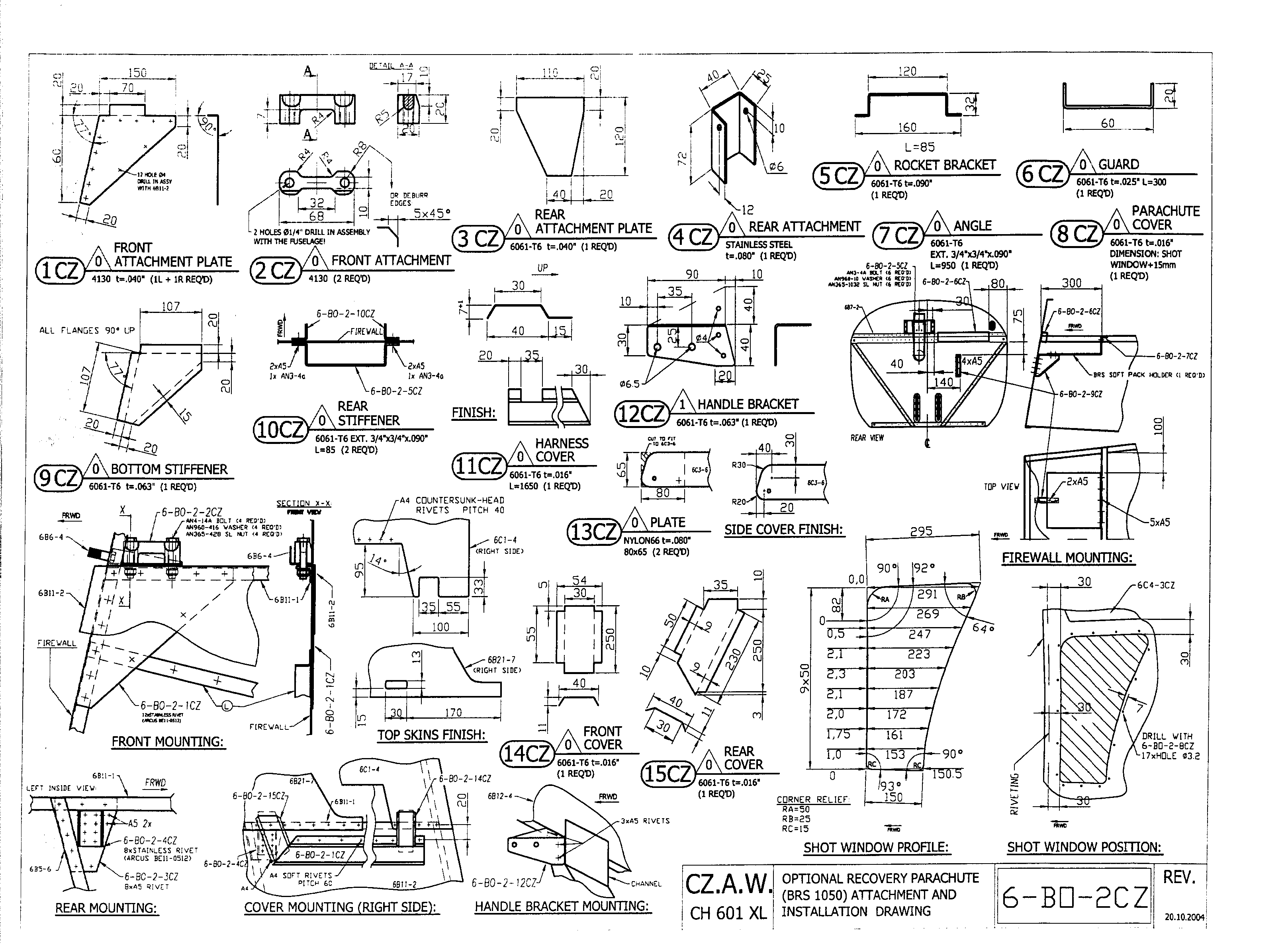

please find the CZAW drawing for the forward installation of the BRS for the 601xl i think the forward part of the bubble is the same on the 650

CZAW used the 1050 which is smaller than the 1350 and I assume lighter. Will the 1350 fit there?

on my recent CZAW xl they installed a "shroud" between the tray and the opening so that nothing can get tanggeld.
I guess the bigger BRS should also fit because on the CZAW Sportcruiserit is installed there and i would call the Sportcruiser an "updated and modified 601xl"
thats also the reason i think the license arrangement got terminated.
