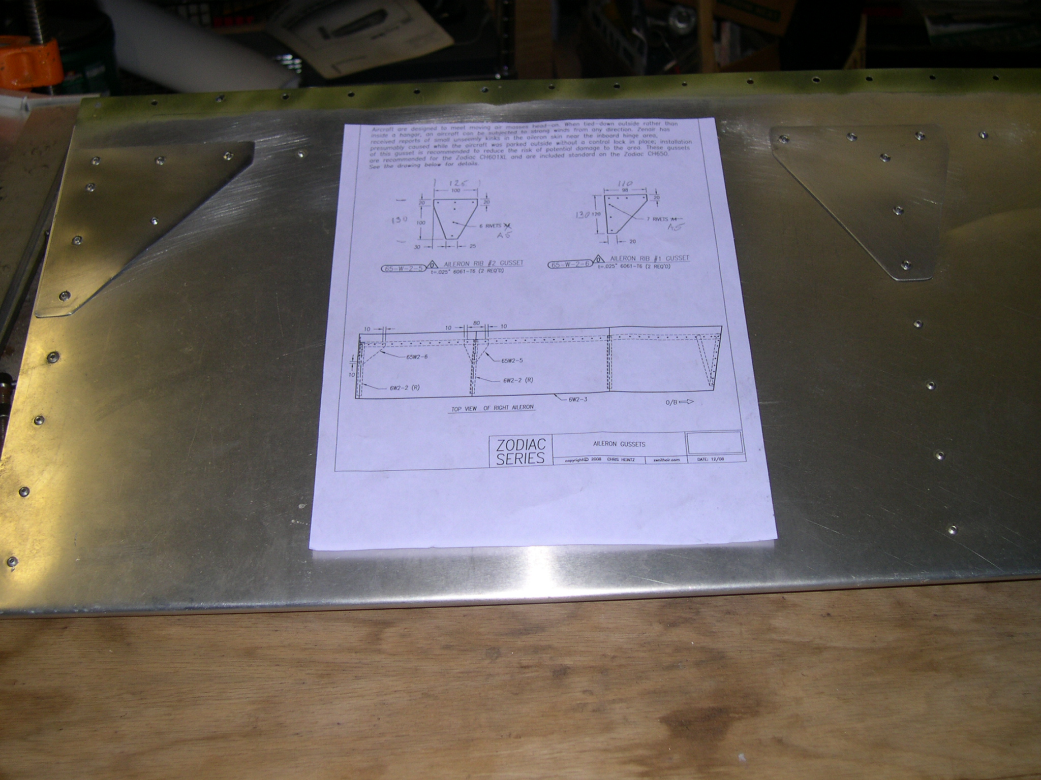

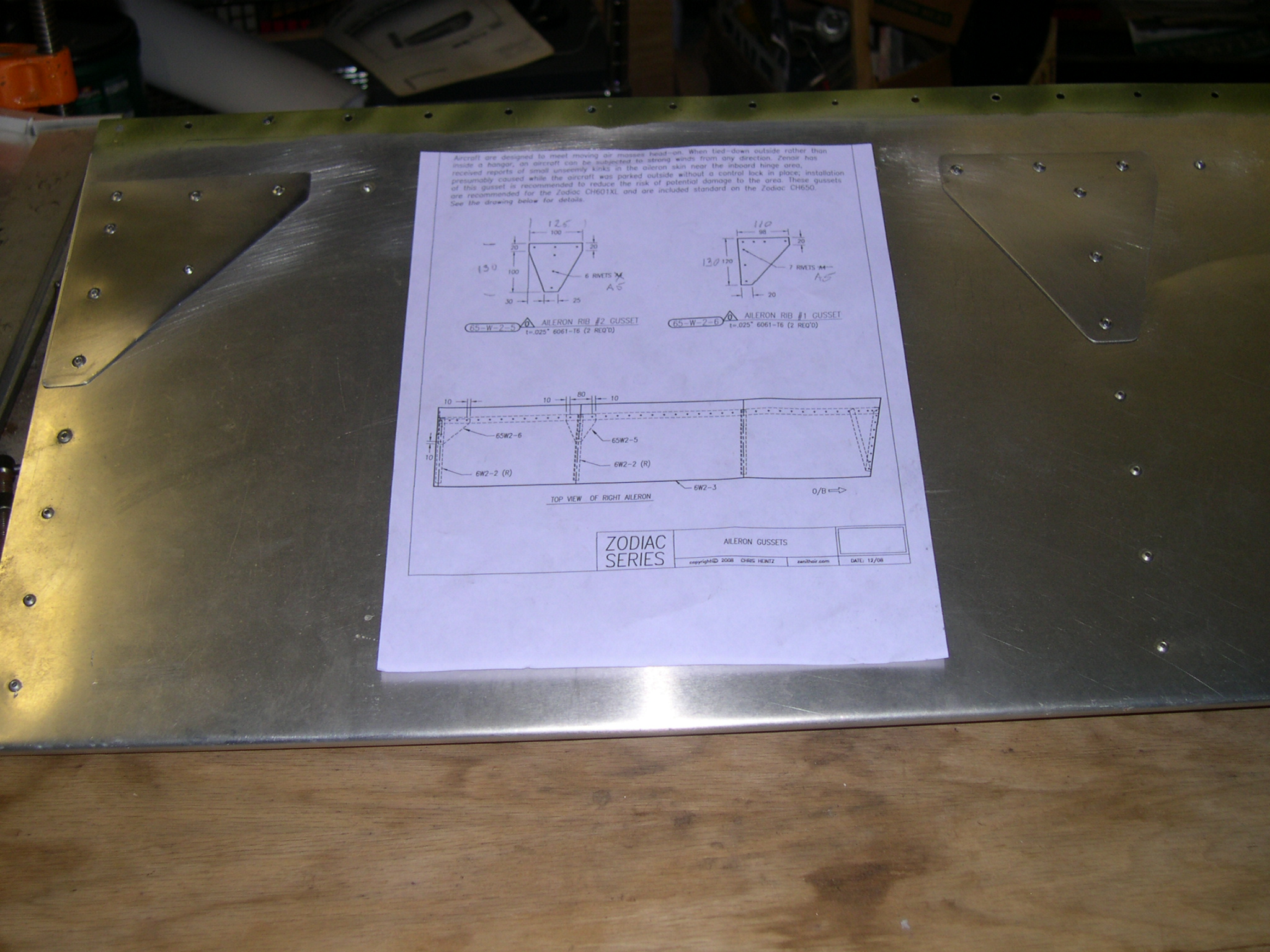

PostPosted: Sun Jan 25, 2009 8:57 am    Post subject: Aileron gussets Reply with quote
Sabrina,
As you can see it would be just as easy to open a couple more rivets and slide them underneath,
it would be easier to pick up the rivet holes that way. You may have a stress point from the outboard end of the gusset where the wing skin bends down to the spar cap when the aileron flexes the skin in a parallel plane to the cap. I think it is minimal though.
Al Rupp
Lake Placid
New York
-------------- Original message from "Sabrina" <chicago2paris(at)msn.com>: --------------
Alex,
Could you please post a picture of your new gussets as installed?
http://forums.matronics.com/viewtopic.php?p=226548#226548

PostPosted: Mon Jan 26, 2009 2:50 am    Post subject: Re: Aileron gussets Reply with quote
(at) Sabrina
Al pics are similar to mine, i can still post u some but i think you can see all at Al pics
i also got this mail from Nick Heintz
......The recommend position of the gusset is underneath the top skin.
Note: how the gusset overlaps the skin is not critical. On your aircraft, if you preferred, it would be acceptable to have it overlap on the outside.
