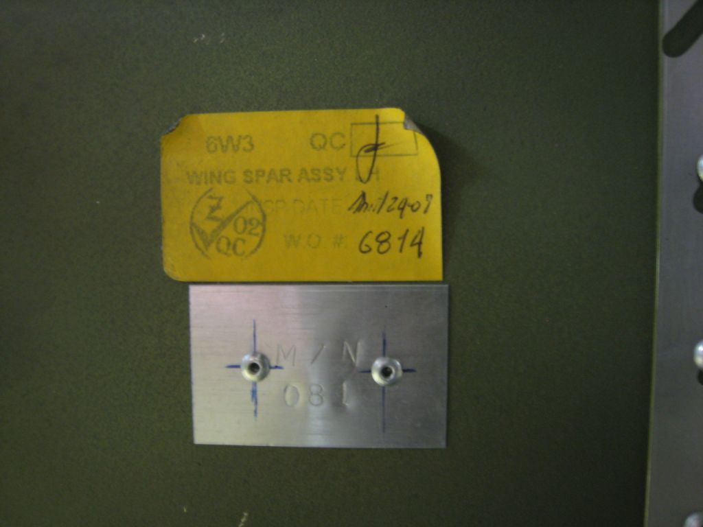

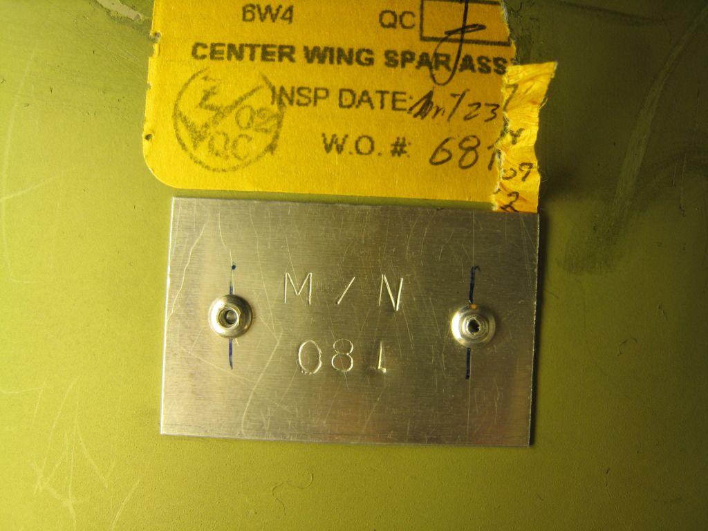

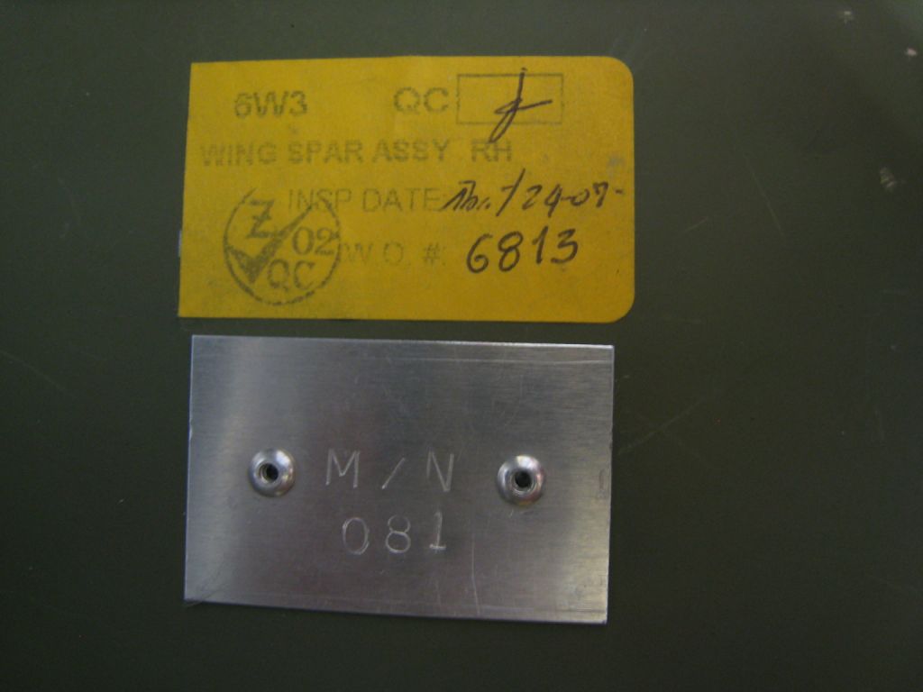

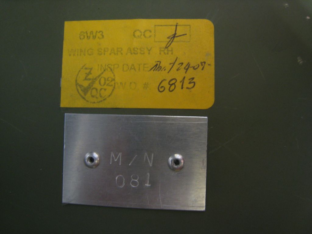

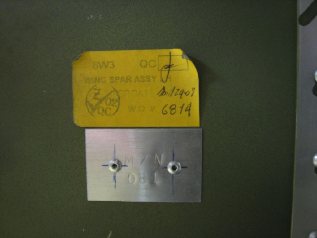

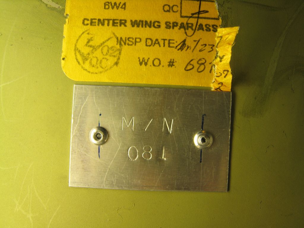

I've attached pictures of the three spar data plates and paper labels from
my 2007-vintage QBK. The "81" number is the "manufacturing number" of the
entire QBK. I'm not sure what the work order numbers "6812" (torn label),
"6813" and "6814" on the paper labels represent. None of them are the serial
number on my plans (or even close).
Somebody at the factory in Mexico, MO (Caleb or Roger or Michael at QSP)
told me that when mine were made they were made in matching sets
(left/center/right). But that at some later time they had improved their
processes to the point that matching a set was no longer needed. I believe
that all the spars are made at Zenith/Canada.
I would definitely get an answer from the factory.
-- Craig
