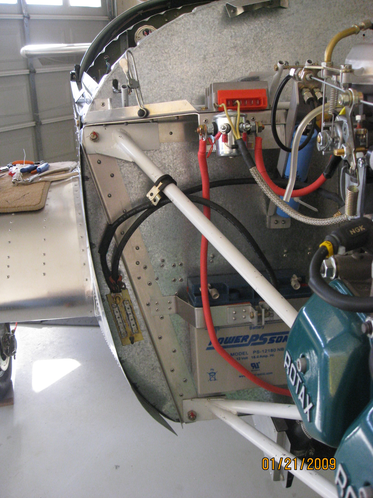

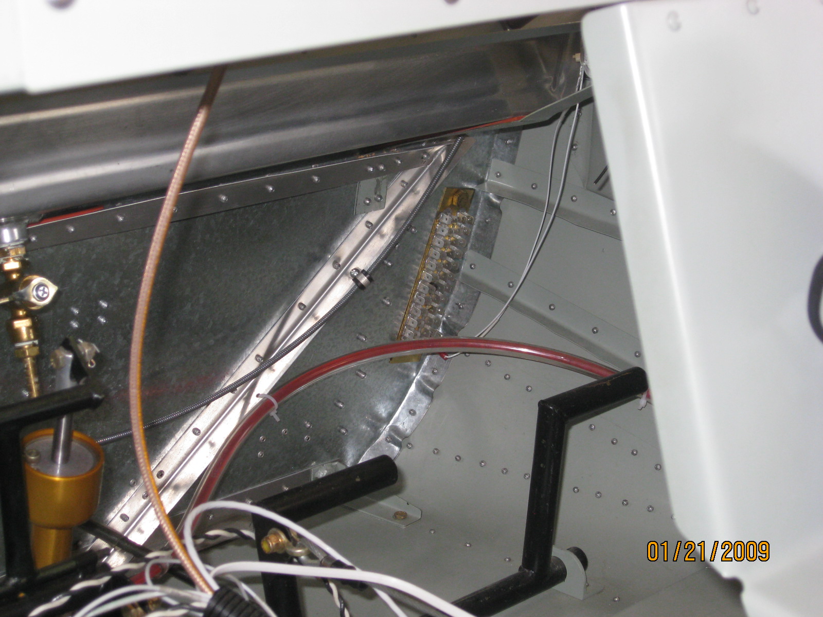

PostPosted: Wed Jan 21, 2009 2:36 pm    Post subject: Ground block Reply with quote
Bill,
Here are some photos of what I'm doing with the ground block and header
tank.
Jerry

jlatimer1(at)cox.net
PostPosted: Wed Jan 21, 2009 5:52 pm    Post subject: Ground block Reply with quote
I was worried about the same thing but I've tried to kick the firewall
while sitting in the plane and have not been able to. My legs won't
reach and I'm 6 ft tall. So I went ahead and installed it this way. I
also thought about the method in your previous method but decided to do
it this way. After all these are experimentals and we are learninig
righte.
Jerry
