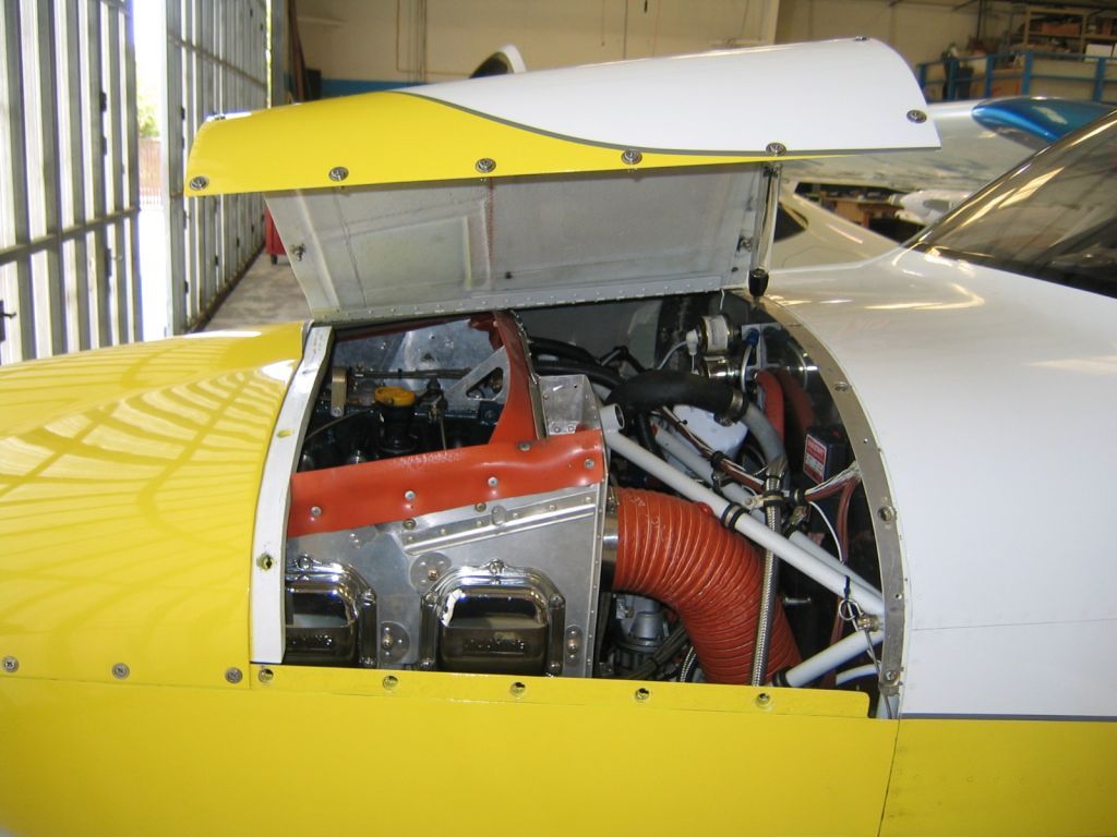

Think about angling the top of the rear baffle forward, like in the picture.
That makes it a lot easier to lower the top cowl into place, and it might
help sealing too. The sides seem to work out pretty well since the cowl
approaches the baffles there at an angle, but the rear stands straight up
and half the time the baffle tends to bend aft instead of forward. The
angle makes it work right every time, and helps even without the big door.
