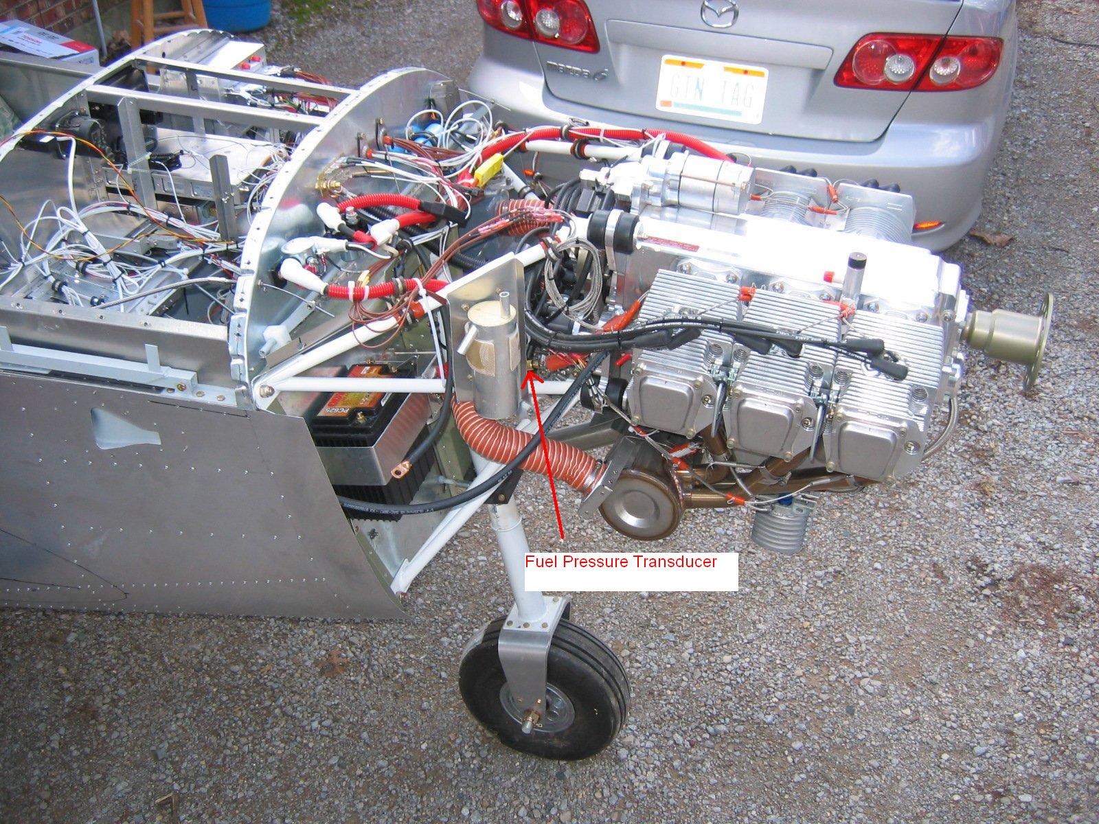

The fuel pressure transducer should be placed between the engine fuel pump and the carb. Cap off the primer port on the gaslocator.
Unfortunately I do not have a good picture of my fuel pressure transducer. Attached is the best I have. I mounted my oil recovery bottle on the right side motor mounts by way of sheet aluminum and adel clamps. I mounted the fuel pressure transducer to the back of this mounting sheet using a big adel clamp around the transducer.

Thanks Dave!! I kinda thought it would have to go in the line from the fuel pump to the carb but it never hurts to ask. I'm doing my oil recovery the same way so I'll just put it there.
