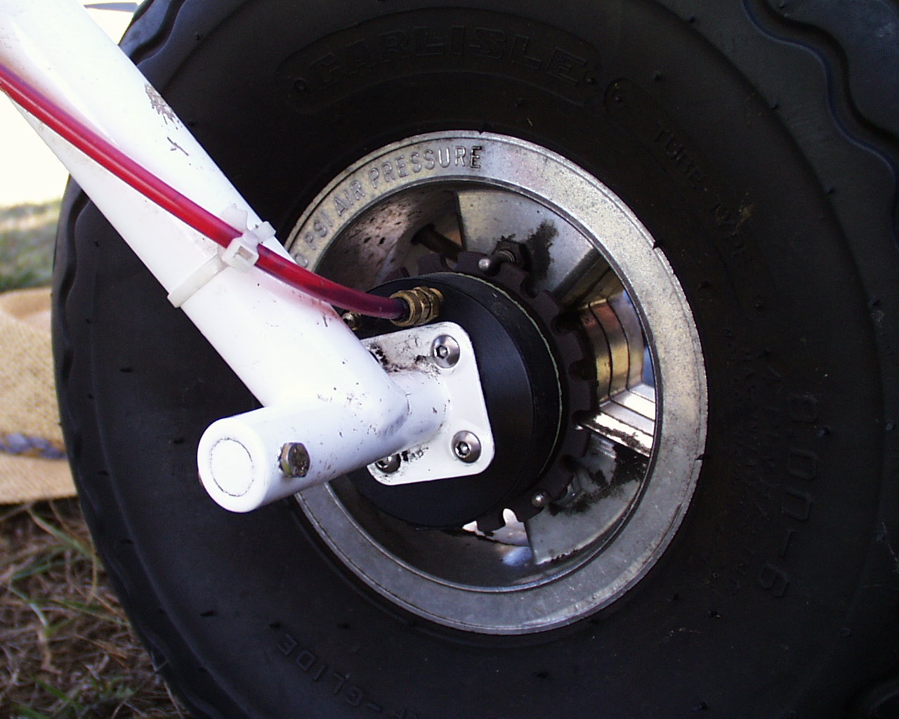

I am about to order the brakes for my Kolb M3X and am wondering if the C90 brakes, that Kolb offers, is adequate. Looking at them they seem kinda of wimpy. What are the pro and cons? I really like the neat installation but wonder if they will do the job.

I have those brakes by Obrien, and they are not strong enough in my opinion. There are times when I am pressing on the pedals about as hard as I can just to get normal deceleration, I can not stop quick with them.
They have been very trouble free and work perfectly, I have not had to touch the brakes in 2 years, but my MK III just needs more braking power than they are capable of.

I have the same opinion about my Obrien brakes. In fact they don't want to hold the plane inplace on pavement for even a modest run-up of 3000 rpm. I went to the Matco eminar at Airventure, the speaker suggested that major factor in braking power is the geometry of the pedal to the master cylinder piston. I have thought about extending the toe of the pedal to exert more force/preasure on the calipers and enhance the stopping power.

I Purchased that same set of brakes from TNK and installed them on my Firestar they work great I would install them on an Xtra with no hesitation

I test flew a re-assembled Challenger this past weekend. It had the Black Max brakes on it which I've heard were good and inexpensive. I can say with certainty that these Black Max brakes are outstanding and wish I had them on my airplane. See them at the following link.

I have the Black Max brakes on my UltraStar and as Tony the Tiger says,
they'rrrre Grrrrreat!
Can't speak for the birds with larger engines, but they'll hold my US for a
full power runup with no trouble at all. Mine has Hegar heel brake master
cylinders, though, instead of FBI's single hand brake master cylinder.

I have the stock Matco brakes and they will hold the plane at least till the
tail comes up with the stock wheel size. A bigger issue is how the brake
peddle to master cylinder leverage is configured. With toe peddles you are
pushing against the rudder peddles and the bigger concern the rudder cables
during brake activation. I have the heal peddles but I understand Paul Petty
had a arrangement with more mechanical advantage. This may be the same set
up that Mark German developed.

Thanks for all the input on this. I believe I will be going with the Matco brakes with a 6" tire instead of the 5". I will also modify the ratio of the brake pedal as I saw some time ago that this may be a problem, 1:1 just won't do it.

I have some idea's on how to change the ratio on the brake cylinders and when done I will post, with pictures. I don't really think it will be to hard, since I had to do this on another aircraft I buildt back in 1993. I'm going to try and make it so others will be able to adapt easily.
Rick Lewis
I'm editing this post to report the company that makes the C-90 brake recommends a ratio of 4:1. This is good information, will post more on this later. Check it out at http://www.tracyobrien.com/moreinfo.asp?id=46

I'm glad you are going to come up with a solution for the Matco Master cylinders also, even though the Obrien brakes are to small for the MK III Xtra, it would be nice if I did not have to press the pedals so hard to get normal braking.
It is very easy for me to get the Obrien brakes on my Kolb so hot that they fade at the end of a long taxi on pavement, leaving me almost no braking at all.

Why reinvent the brake peddles. Paul Petty had a set that has more ratio in
his Kolbra. He posted photos that are likely in the archives. Seems like
there was even a video. If I remember correctly Mark German develop the
brake peddles and may have made a copy for Paul. The guys that now own one
of their planes are on the list.
