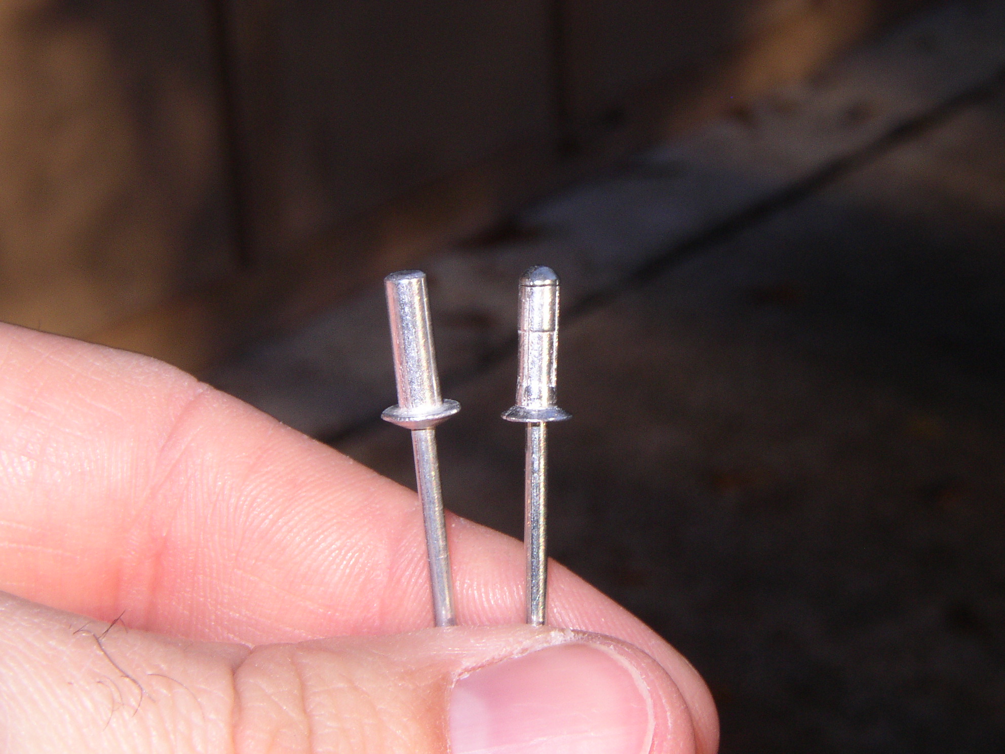

I'm working on installing a set of bubble doors purchased from Skyshop and I have a few questions. I tried asking Skyshop, but they said they don't support ZAC anymore.
The doors were supplied with 70 A5 rivets, 30 A4 rivets, and 35 rivets I've never seen before (in picture on left). They appear to be 1/8", but I'm wondering if they're specifically made for riveting lexan. What the heck are these, and where do I use them?

I think they look sort of like Cherry rivets. Supposedly a substitute
for Solid Rivets but CH doesn't favor them too much.

The rivet on the left looks like a "closed end blind rivet" like the ones I
used to make my glued-up fuel tanks. They are capped at the end so that
stuff (fuel or air) does not bleed through the stem. I don't think they
would work any different than the Avex rivets for this purpose. I don't see
where these would work any better for lexan. They probably included them
because that is what they had on hand.

To their credit, they were somewhat helpful in identifying the mysterious rivet. It is normally used for fuel tanks because the mandrel provides an air and water-tight seal. They indicated it's meant for riveting the lexan to the door. No, I don't quite get that one either.

4. The mystery rivets: Just had a thought -- I remember that the stress on the attach point on the door, for the gas strut, is high. Maybe these rivets are a little stronger? Not sure if they retain a steel mandrel like the Avex ones? If you think they're stronger, may want to consider using them at that location..
