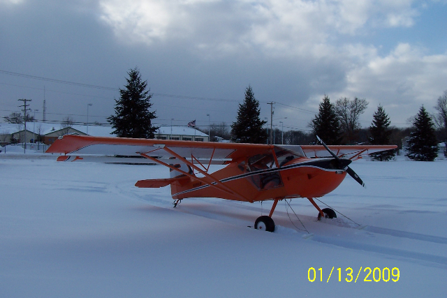

I couldn't stand not flying today, so I sucked it up and went out. I
was a bit reluctant because I woke up a t 3 am, couldn't get back to
sleep, and figured by 11 am or so, that I probably was too pooped to
participate. Got an hours' rest and the pretty clear sky and calming
winds...only 20 mph at altitude....told me this was my only shot for
at least 3-4 days, what with below zero coming (yeah, I know, I'm a
wimp, Leonard) for the next 3 days and a storm promised. I got
airborne without much of a problem, circled the field and came back
in. Wind was pretty much down the 27 runway...I cleared the trees to
the east, landed pretty short, felt it become real normal and slow,
then powered it up and took right off again, using less than half the
1700' field for the landing, the roll-out and the takeoff. Flew it
over to Napoleon Airport (3NP), landed on 33 there...wind was
favoring that one over there. I went into the restaurant, and seeing
nobody ready the hang a laurel wreath on me for valor, I left and
went back up. I saw some snow headed my way on both sides of the
plane, so figured I'd better beat it back home.

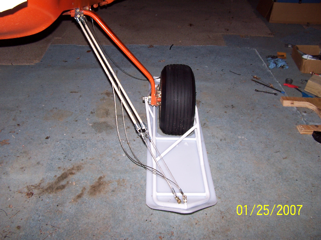

So three landings in the book, the plane works beautifully with these
skis....I was plowing through the fresh snow at 2100 rpm, much better
than the old "cheese slicer" models. Boy, the guy who built those
must've been a damn photographer in another life.

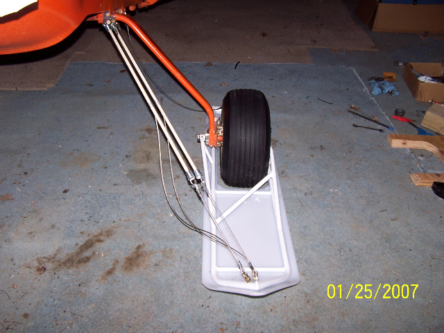

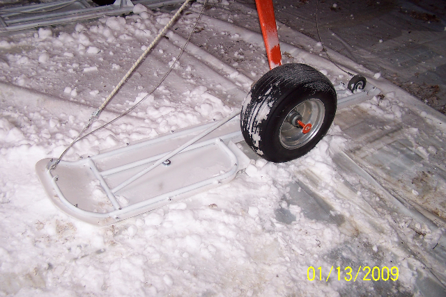

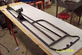

Lynn C Beautiful set of skis. Did you gas weld them? There are 2 brackets on the front tube. You used 1 for bungees. What is other 1 for? Did you heat the bottoms to curl the edges and the rear kickup? What is the orange piece sticking out of the bearing grease cap? I have bigger bush tires C I guess I could make a taller tower to accommodate them. I will have to have a set of axles made 3" longer so they will stick out the back of the mount. Thanks for the briefing and sorry to ask so many questions C but C again C those are beautiful skis that can be mounted very quickly. Do you have a tail wheel ski?

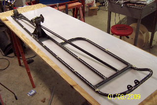

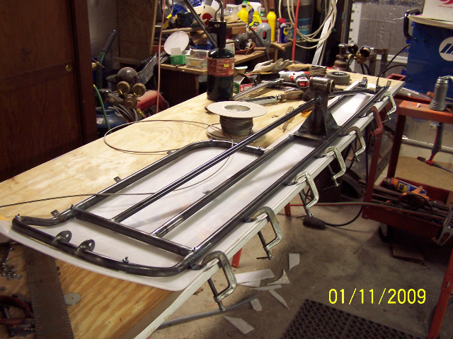

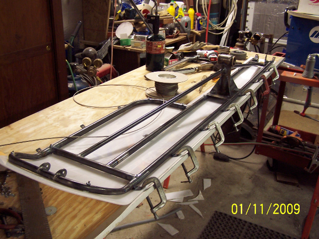

I used my new Miller TIG welder for all welds. The two brackets/tabs
are both for bungees and the front restraint cables...I just haven't
installed the redundant bungee/cable set yet. The same goes for the
rear. And my CFI, Brian, won't see the skis until they are all in
place...in fact, he won't hear of this flight until the cables are
all in place. Others have said "they only use one set of cables and
bungees up north"...well I ain't "up north" and I have to fix my own
plane, so I'll go with the dual cables/bungees.
I wanted to get a test flight in before the weather locked me out for
the next 3-4 days, so I went minimal on the cables for this flight.
Yes, I used a propane torch to heat the 3/16" HDPE material so it
would bend. The longer side bends were the toughest, as they tended
to spring back...I would have needed another torch and possibly
another person to facilitate this bending operation, but the tabs
along the sides hold it in position, but there are "scallops" visible
in the surface. The orange thing is a "stand-off" for the wheel
pants...no point in removing it for the winter, in fact, I'd like to
make a wheel cover that would bolt to this stand-off and maybe reduce
the amount of snow that collects inside the wheel dish. No tail wheel
ski...I heard that they can be a problem with aerodymanics, trying to
make the tail do strange things, and I figured I didn't need that
kind of grief.

Lynn, Beautiful set of skis. Did you gas weld them? There are 2
cap? I have bigger bush tires, I guess I could make a taller tower
briefing and sorry to ask so many questions, but, again, those are
wheel ski?

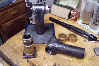

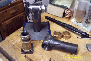

A real nice job Lynn. How about a couple of close ups of the inside and
outside of the attach points. Next year a look at the axles would be
appreciated too.

--> Kitfox-List message posted by: Lynn Matteson <lynnmatt(at)jps.net>
kind of grief.
> wheel ski?
> Pat Reilly

Not sure what you mean by the "inside and outside of the attach
points", Noel...you mean the stub "axle" where the ski pivots? or the
cable attach points?
inside and
appreciated too.
Noel

PostPosted: Tue Jan 13, 2009 4:28 pm    Post subject: Ski report...flying Reply with quote
That's the exact reason that my CFI strongly suggested the second set.
I may try building a tail ski....if it's not too large, it probably
wouldn't wreak havoc with the flight characteristics, I guess. It's
worth a try.
Mine are dead center of the left-hand seat. : )

On Jan 13, 2009, at 7:06 PM, gary.algate(at)sandvik.com wrote:
Lynn
When I flew up in N.Ontario everybody used a secondary bungee with
a restraint cable front and back. I know its important because I
landed with one broken as it evidently got damaged when I was
taxiing thru a strong snow crust on take off.
I also had a tail ski and although it made a fair difference to
manoeuvring performance on snow I never noticed any issues in
flight. Mine wasn't really "engineered" just an aluminum frame and
a piece of teflon. Hell, my balls never in the centre anyway !!!!!!
Gary

Several of the ski manufactures had a second cable on the front that they called a "crust cutter" to keep the ice from popping the main cable, but I have not seen a redundant set of bungees or springs.

PostPosted: Tue Jan 13, 2009 6:39 pm    Post subject: Ski report...flying Reply with quote
I just drag them into the email and see how big the file is, then hit
"large", "medium", or "small" if they are too large. I also have
Photoshop Elements, but that's a longer process.
Which are the "ones"? ....both the axle, and the cable attach points?
The square block here bolts to the inside/backside of the Grove
landing gear. I'm not really sure what you wanted to see.

I used my main restraint cable on the front as a crust cutter, by
bringing it down to the front tube of the ski, then doubling it back
up about 9", installing a thimble and nicopress sleeve for the bungee
to connect to. When I get to it, I'll make up the second, redundant,
cable/bungee and install it, so it will be just like the previous
skis I made, pictured here. These are connected to separate 3-hole
tangs bolted to the float brackets on the Kitfox IV. So there is
complete redundancy, unless the bolt fails and that is pretty
unlikely, I think. The rear restraint cables...also two of them
(although this picture shows only one rear at the time) will connect
to two separate 2-hole tangs, bolted to two separate float
brackets....about as separately redundant as I can make it.

I thought you used a Mac....
The pics I wanted to see was the ski attach points behind the wheel. I have
to take my whells off to put the skis on. Did it once. It's quite a
process because the brakes have to be disassembled than everything has to be
re assembled. Changing out the axels (stubs) would be a lot easier and
faster. I was also wondering about putting a set of the narrow wheels on
the straight skis I now have. Of course then I would be flying without
brakes.
Noel
Noel Loveys
Kitfox III-A
Aerocet 1100 Floats
Lynn Matteson
Posts: 2778
PostPosted: Wed Jan 14, 2009 12:49 am    Post subject: Ski report...flying Reply with quote
I do use a Mac. It's an eMac that I bought in about 2001 or 2002. I
got Photoshop Elements for it about a year later.
Did the pictures help you figure out the mounting of the skis? I can
take more pics if you need them...in fact, I'll bet I could pull the
large cotter pin, remove the nut and slide the ski off the stub axle
without even undoing the cables, or jacking up the plane. In fact,
after the plane was initially jacked up to install the stub axles, I
did not have to move the plane in any way to install the skis. This
is the only way to fly, if you'll pardon the expression, around here
where the snow comes and goes so frequently. I just can't get over
how easily these skis install, and in fact if I were to substitute
the present cotter pins for those safety pins, it'd cut the install/
remove time by a couple of minutes....hey, now there's a topic for a
U-tube video...nah, I guess not.
Let me know if you want more pics, Noel.
