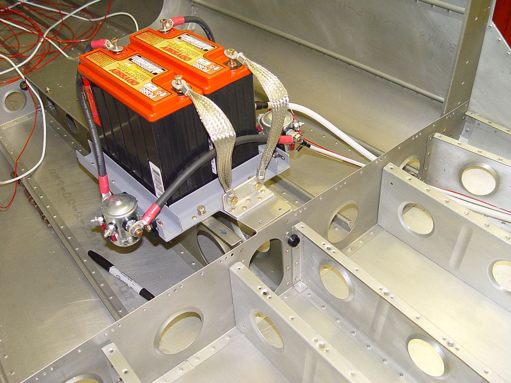

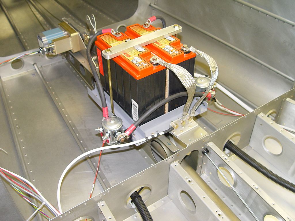

I'm attaching 2 pics of my interpretation. You'll notice I added the
ground wire for the forest of tabs in one pic.
Thank You.
Bill
