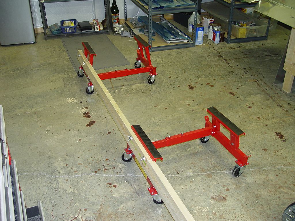

PostPosted: Mon Jan 12, 2009 7:18 pm    Post subject: Fuse Stands Reply with quote
I used two motorcycle stands from Harbor F (they were on sale). I used a couple of 2x4s to connect them, then I threw a 4x4 board on top. Crude but it is VERY easy to roll around.
Perry, Phil wrote:
Hi,
I'm expecting my QB fuse in the coming weeks and I'd like to have a fuse stand waiting on it.
After researching on Tim's site and he a photo of Rick Sked's fuse holder.
Does anyone else have photos of similar fuse holders?
Phil

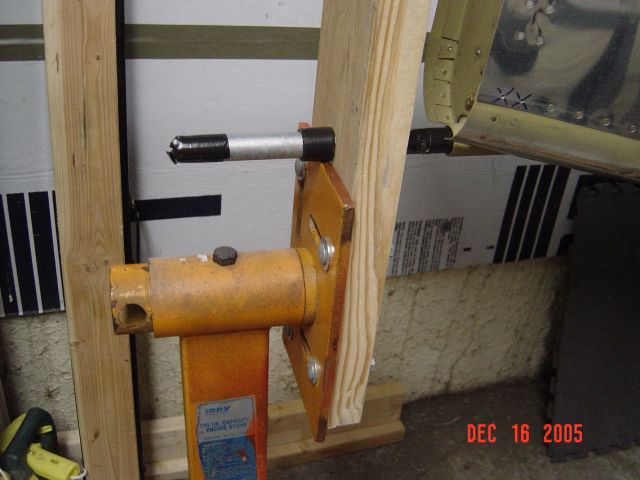

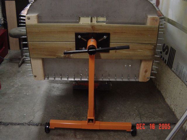

n8zg(at)mchsi.com
PostPosted: Mon Jan 12, 2009 7:29 pm    Post subject: Fuse Stands Reply with quote
Phil –
I used two engine stands from Harbor-Freight on my RV-7. Minor changes to the aft attachment would adapt it to the -10.
Phil

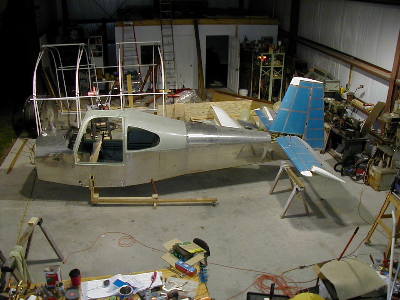

pitts_pilot(at)bellsouth.
PostPosted: Mon Jan 12, 2009 8:37 pm    Post subject: Fuse Stands Reply with quote
Here's the best pic I have of my fuse stand. all 2X4s .... the uprights
have a screw (protect the spar with plastic hose around the screw)
through the wing attach holes, and the blocks on the step keep it from
sliding off. One crosspiece across by the uprights. Then I added an 8'
2X4 under that because the CG went too far aft with the tail feathers
on. Note the block on the floor next to the step ..... the 8' 2X4 sags
too much and needs another caster. This keeps the fuse low so you can
lean over to work on the innards and it rolls around when I need it to.
Linn

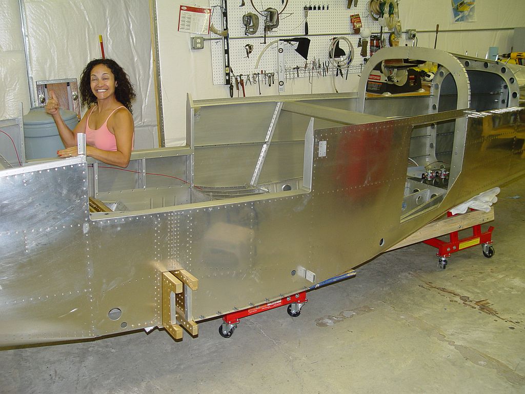

rv10rob(at)gmail.com
PostPosted: Tue Jan 13, 2009 8:16 am    Post subject: Fuse Stands Reply with quote
I copied Rick's design and am very pleased with it:
http://nerv10.com/wcurtis/fusestand/fusestand32.html

ricksked(at)embarqmail.co
PostPosted: Tue Jan 13, 2009 8:34 am    Post subject: Fuse Stands Reply with quote
It worked well for me and the added benefit after I was done with it, I screwed a 4 x 4 sheet of plywood I had laying around to it and now its a roll around storage table.

pascal(at)rv10builder.net
PostPosted: Tue Jan 13, 2009 8:44 am    Post subject: Fuse Stands Reply with quote
I sort of did too except I found that I had lots of wood from the crates the kits came in and used all that wood. Bought the caster/wheels from HF. Works well and is inexpensive
