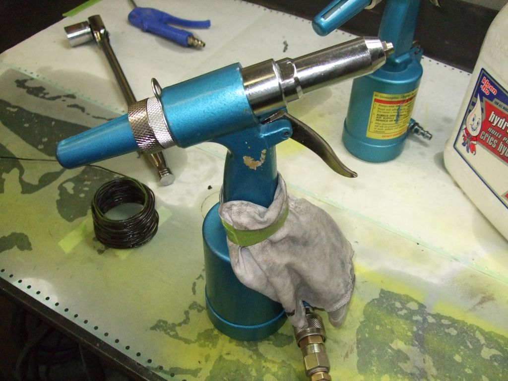

When I first started looking for a rivet puller, I shied away from the gun that was being offered by Zenith because I had heard from builders on this List, that there was many instances of cracking in the casings. As a replacement I decided to go with a gun that was being offered by ACS ( see pic below ) however it is starting to look like this was not my best decision.
I had difficulty with the setup instructions ( Chinese instructions ) and for the life of me I still have not been able to get the oil level correct. The instructions state that the unit should be filled with oil up to the top of the frame, without showing where exactly what they consider as being the top or the exact filling level is.
My second mistake was purchasing two guns so as not to have to continually swap out the two tips. As it stands, when I do get one of the (at)#$%&* things to work, it won't pull more then a dozen or so rivets, before me being obliged to open up the air cylinder and start fidgeting with the oil level again.
I am basically a neat person, and I can't live with the constant spewing of oil out the front, or the back stem catcher, and ending up on my freshly made parts, or my work table for that matter. I am now in the process of trying to look for a replacement, but all the suppliers seem to have the same low cost gun. The list of resellers I checked with is rather extensive and includes, but is not limited to, The Yard, ATS, Browns, Cleavland, US Tools, all registered trademarks etc, and a few more I will not mention.
My question to the List is this, is the rivet gun being sold by all of these suppliers the same gun. I have looked as best as I can, and every last one is showing what looks to be the exact same unit on their web-page, with the only difference being the color or the pricing. The cases are identical, the same tips, the same nose pieces, hell they even the same triggering mechanism, and the only difference so far is prices, that are anywhere between 40$, to a 140$.
For those of you who have used any of the above guns, are you aware of any difference in quality of these guns, or is it a " find the peanut under the shell " type of situation for me to get a proper replacement that will work,

I have one I found on ebay that has been working good for me. Search for: NEW AIR POP RIVET GUN
The company is Great-Tools.
I modified the nose pieces myself, follow link below to learn how:
http://mykitlog.com/users/display_log.php?user=rlendon&project=113&category=0&log=10097&row=674

Bob, I used the Zenith supplied rivet puller without any problems at all. They warn you that the case may crack if you use too high of an air pressure. I ended up using a few pounds higher (at the compressor) than they recommended to get the 5/32 stems to snap.
