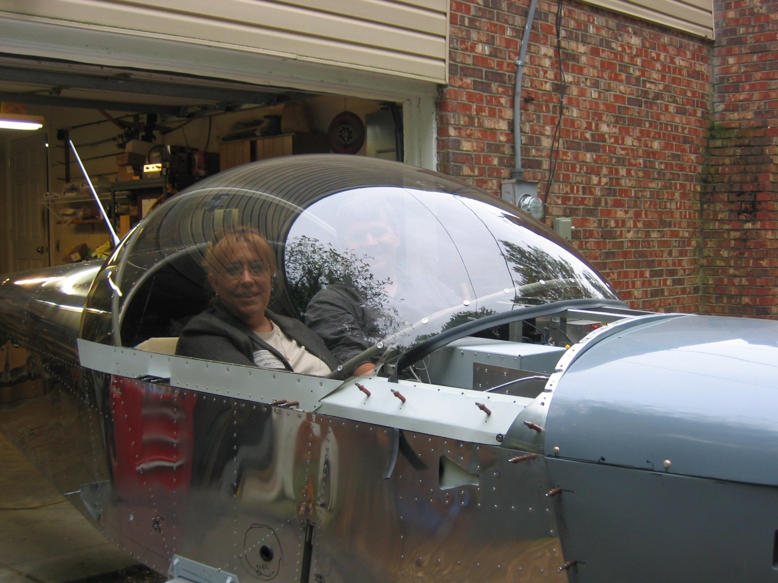

Rich,
My canopy rail is close to being flush to the fuselage sides all along it's length. Not exactly flush, but close. Wherever it is not flush, it overhangs slightly. The attached picture is the only one I could find that kind of shows the fit. This was accomplished by judicious bending of the frame. Without access to any kind of bending equipment, I used clamps, table corners and a bit of mallet hammering to coax it. Once I got the frame w/ tubes attached to sit where I wanted it, I placed the strikers to match. By the way, I had to shim the strikers up for the best latching spot.
Good luck,
