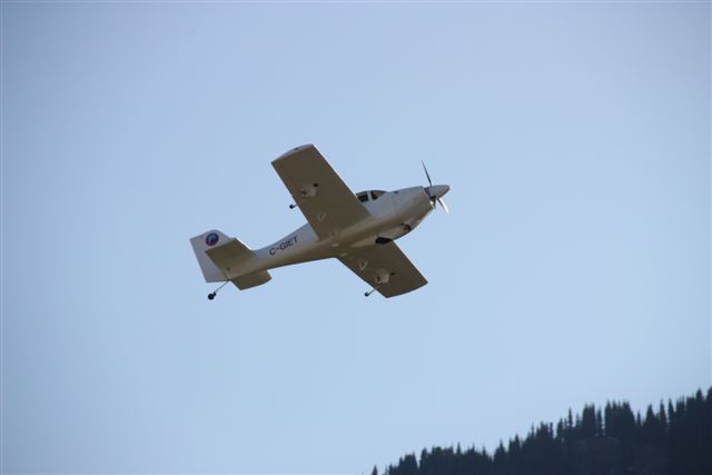

I am also flying with the silicone hoses from Stefan Ingemarsson in Sweden and find them to be very high quality and easy to install. For the spring-clips I could not find a special tool and used an old pair of two-position pliers, which worked like a charm. Europa Aircraft could not supply the formed hoses for the classic mono-wheel at the time.
I also recently finished and installed fairings for the main wheel and have flown with that installation for a few hours. It turns out, that there is lots of room for a landing light in the forward part of the fairing, which is attached to the swinging arm. I have made moulds for the two-part fairings and could produce the moldings for interested parties.
Peter Timm
