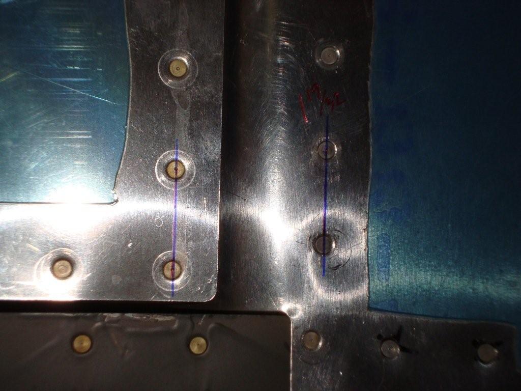

Recommend going back to the 7/8” spec on one elevator and then measuring the gap between the elevator and the HS at the most inboard location and the most outboard location.  The easiest way to do this is to make a line between two aft outboard and two aft inboard rivets on the HS, and then a line on the corresponding rivets on the elevator.  With the elevator clamped in the trail position, measure between the two lines.  You should find both measurements to be about 1 19/32”.  If they are exactly the same, then you know the elevator is mounted parallel to the HS.  Do the same process with the right elevator, starting at 7/8” on the rod end bearings and adjusting (1/2 turn or so on each on) to get the same gap measurement that you did on the left elevator.  Photo of the outboard gap measurement lines attached.
The objective is to get the elevators parallel the HS rear spar.  If you counterweight is made correctly, this you give you close to the 1/8” gap.  If you don’t have a 1/8” gap, don’t try to get it by adjusting the rod end bearings – keep the elevator parallel the HS spar.  You may need to drill out the counterbalance rivets, adjust and then replace the rivets to get the 1/8” gap.
